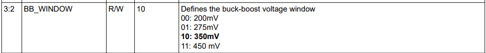

  1. What is the funtion of BB_WINDOW? The explanation below is little, so I don't understand how it works.
2. What is the function of HYS_CURRENT? The explanation below is little, so I don't understand how it works.

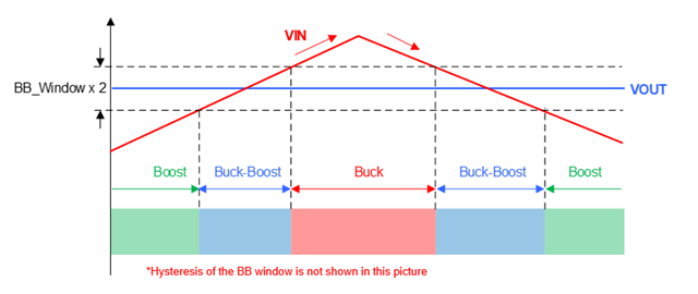

  • Hi Yamamoto-san,
    Here is a picture which shows clearly what is the "BB(buck-boost)_window", hope it works.
    HYS_CURRENT = peak inductor current - valley inductor current.
