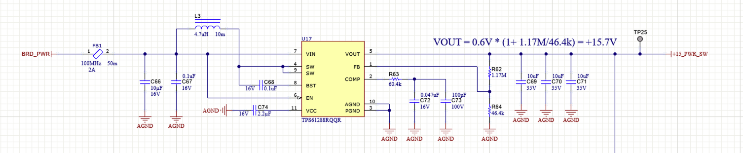

Hi Team,
I am using TPS61288 in one of my design.
1. VIN Range = 2.7 to 5.5V
2. VOUT = 15.7V
3. IOUT = 0A to 0.25A
Please check the design below and let me if there is concern.

Hi Sanjay,
Can you please let me know the p/n or datasheet for inductor and output capacitors? Thanks.
Nathan
Hi Nathan,
Please check the details below -
1. L3 - MSS1278-472MLB
2. C69/C70/C71 - GRM21BR6YA106KE43L
Sanjay

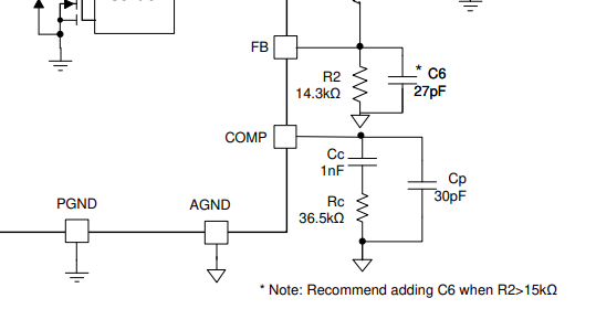

Hi Sanjay,
Suggest to change COMP parameters based on datasheet typical application, and also add a C6=27pF as show below.
You can also refer to 9.2.2 Detailed Design Procedure on d/s for more details.
The other things looks ok.
Thanks.
Nathan
Hi Nathan,
I got those values from https://webench.ti.com/power-designer/switching-regulator.
Can you please confirm which one I need to consider ?
Sanjay
Hi Sanjay,
We suggest to follow on the datasheet guide if there is a mistake usually, and it looks not common for the compensation value on previous schematic I think, so we suggest to refer to datasheet.
Please let me know if more questions.
