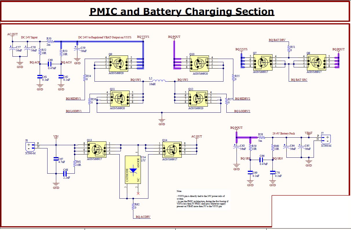

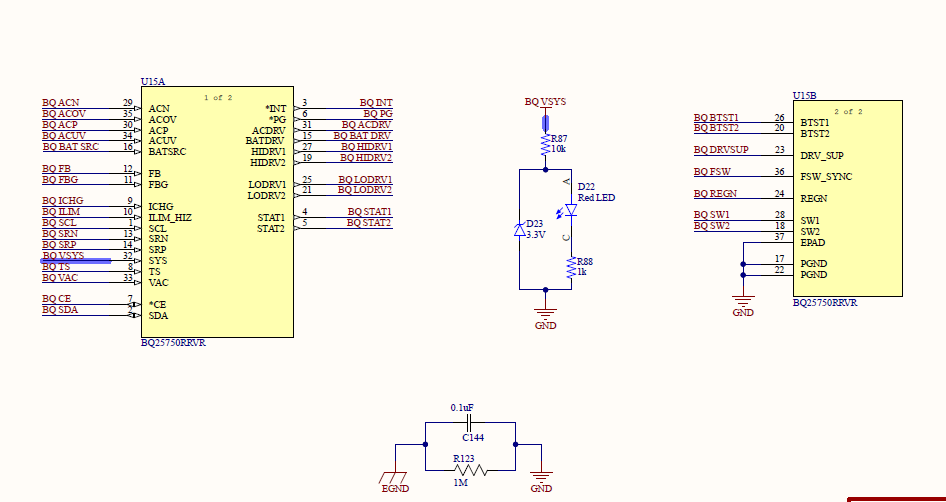

Below we are adding the screenshort of our schematic please review it.

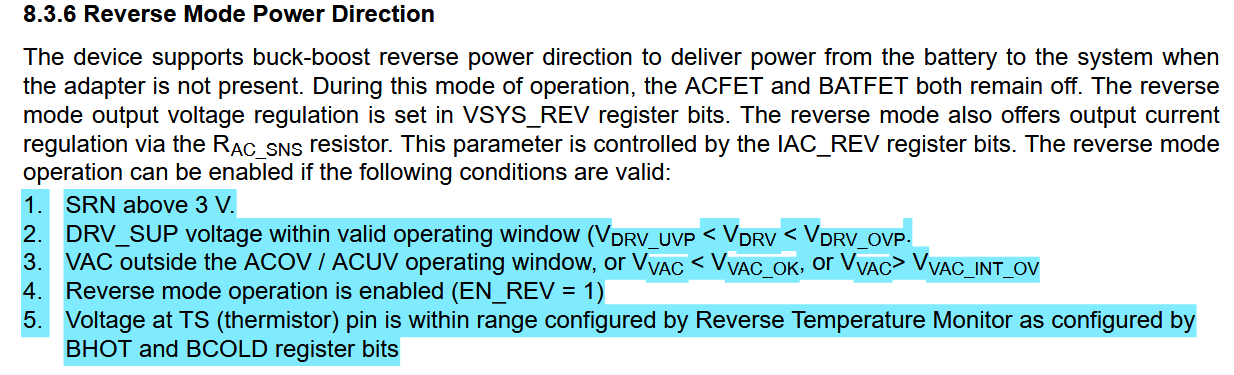

  • Hello Druvit,
    Thanks for working on this. Is this the same project as the questions asked in this other thread?  BQ25750: BQ25750 - Register writes to POWER_PATH_CTRL (0x19) not persisting, reverse mode fails to regulate VSYS
    1. Here are the conditions required:
    2. DRV_SUP should be enabled whenever the charger is forward or reverse mode.
    3. Yes, this is an acceptable debugging method. Is DRV_SUP powered REGN or an external gate drive source in your schematic?
    4. What value is being set in the VSYS_REV register? Is the system writing the VSYS_REV register correctly?
    5. I would check the BQ25750 registers first. If the values are being set correctly, I would recommend looking at the SW1, SW2, VAC, and VBAT waveforms.
    The schematic looks good.
