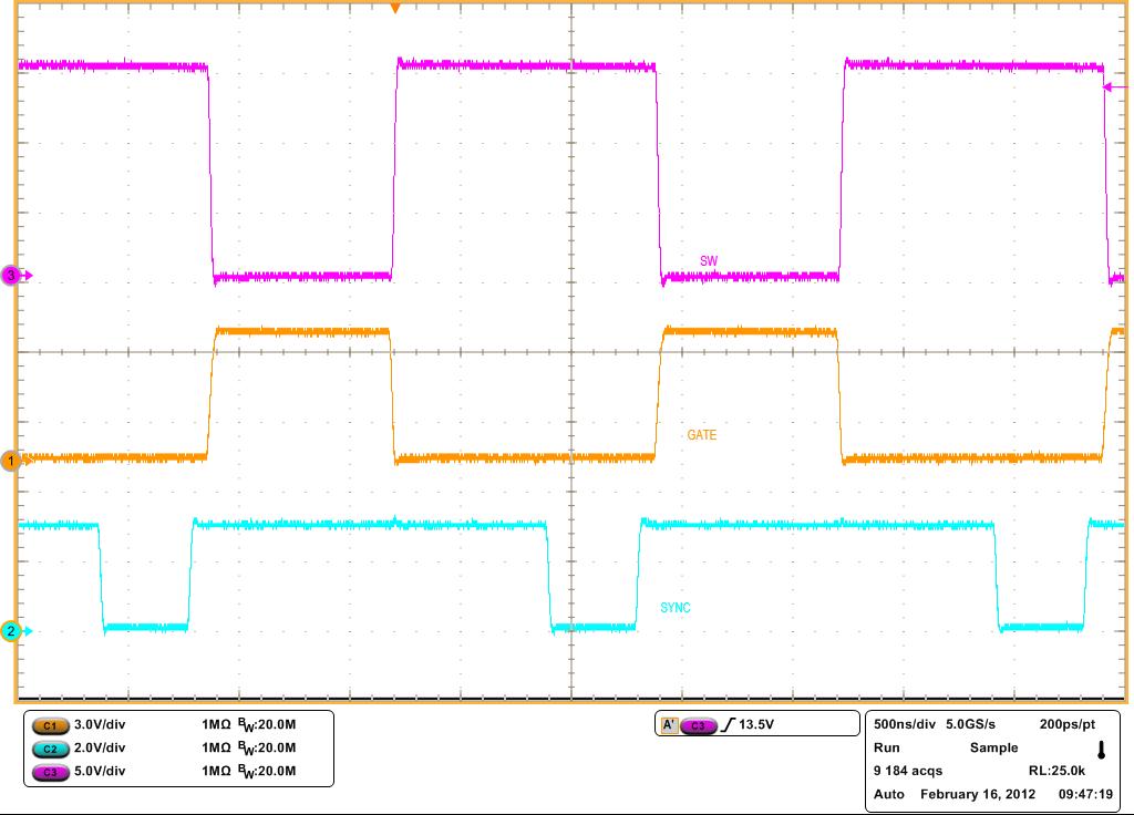

I plan to synchronize the LM3481 with an external clock by driving the FA/SYNC/SD pin with a 300kHz clock.  Per page 11 of the data sheet, the synchronization pulse needs to be greater than 300nS and less than the minimum duty cycle of the switcher.  What should the polarity of the pulse be?
