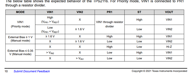

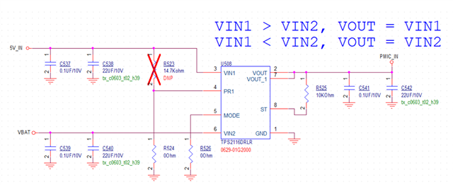

May I know if there any problem if the difference between Vin1 and Vin2 is very small? image.png
For example, Vin1=4.5, Vin2=4.45
Vout will be  Vin =4.5V
Is it correct?
What is the switchover threshold?
