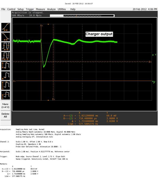

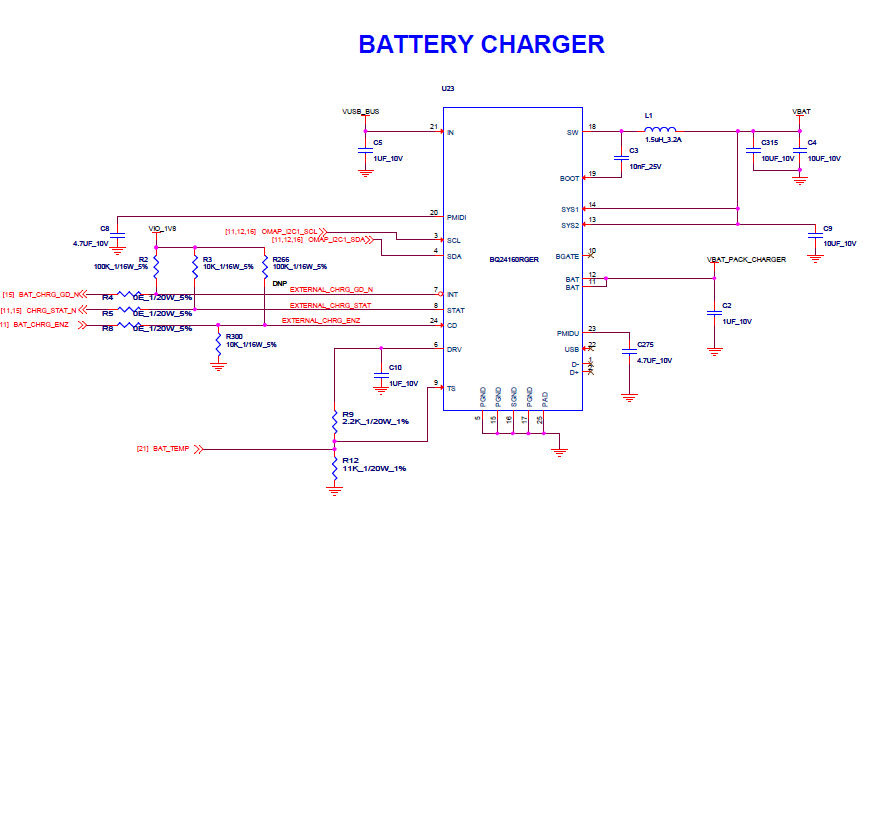

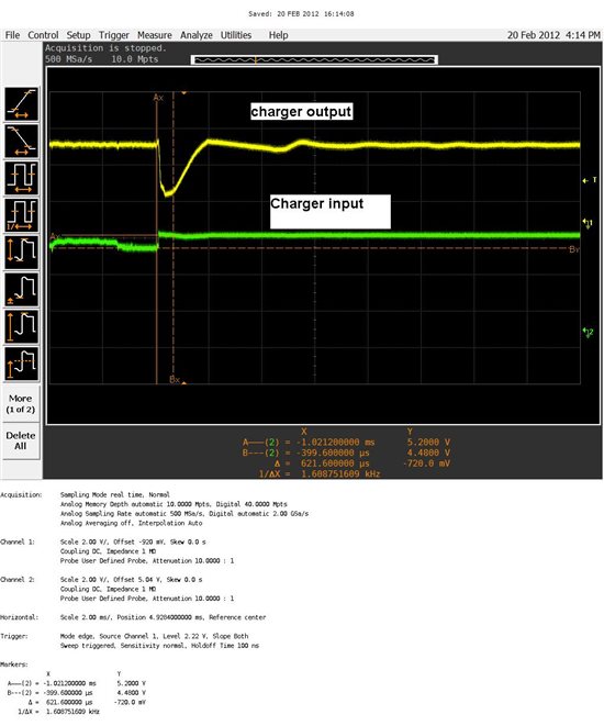

   I am using BQ24160 IC for my project, my problem is, the charger IC is generating interrupt (reset) to the processor when battery is not present, then again system
is re-booting. please let me know what are the registers i need to do? my system is working when battery is present.
