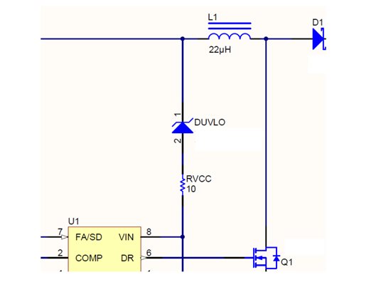

Is thre any option available to implement the adjustable UVLO using external circuitry in LM3478. Basically I want to implement UVLO around 6V-7V.
Hello Suresh,
you could try to implement the following circuit:
Without the zener diode the LM3478 starts switching at Vmin = 3V
With the zener diode the LM3478 starts switching at Vmin = 3V + Vzener hence you could use a 3.3V zener for your application.

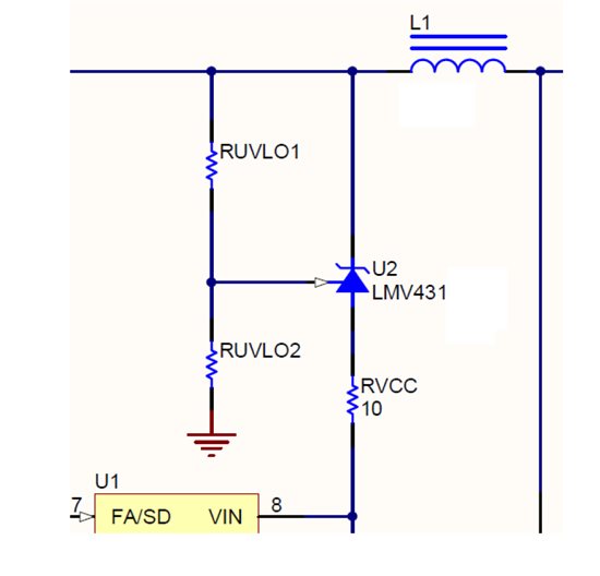

A more general circuit is the following:
It uses the LMV431, please take a look at the datasheet :
http://www.ti.com/lit/ds/symlink/lmv431.pdf
Hope that helps.
Giuseppe

Vin is conencted to decap after the 10 ohm resistor? I could not see full circuit.
You have mentioned LM3481 is much more reliable than LM3478. Is thre any issues with LM3478.
yes Vin is connected to the bypass cap after the 10 ohm resistor.
