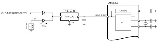

We are considering building a board using the BeagleBone as a reference design.  Our application would likely require a backup battery to run the RTC in RTC Only mode when power is off/disconnected.
The hardware design guide claims you can use this PMIC in RTC-Only mode:
http://processors.wiki.ti.com/index.php/AM335x_Hardware_Design_Guide#Designing_the_Power_Subsystem
But all other documentation including BeagleBone schematics and TP65217 User Guide has no mention of backup battery:
http://www.ti.com/litv/pdf/slvu551a
Is the hardware design guide wrong, or am I missing something.  Can you simply hook up a battery to the LDO input?
