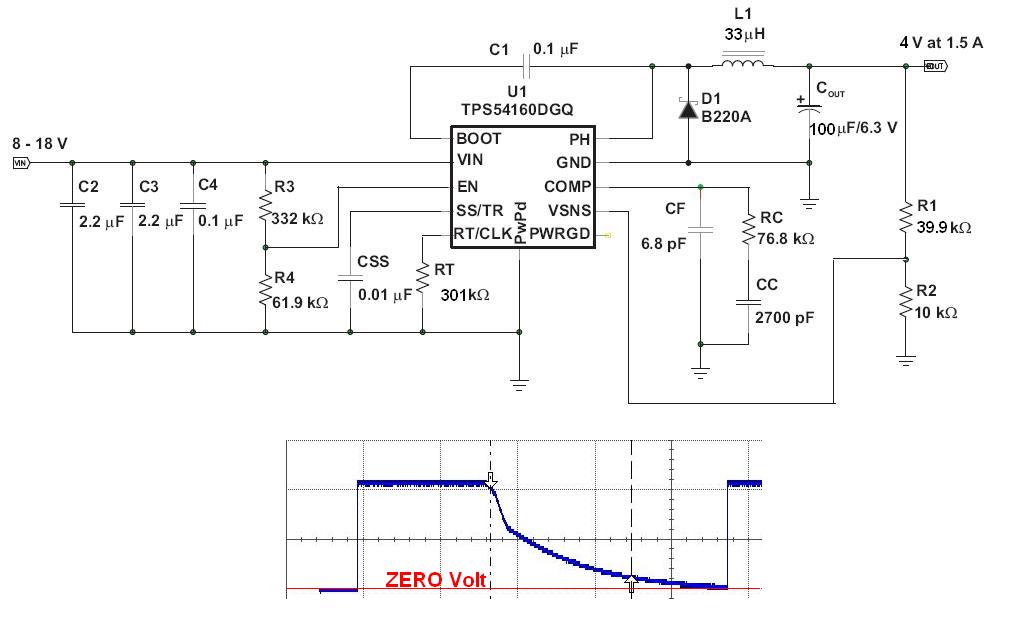

Did you encounter the power-off problem of TPS54160 DC/DC step-down converter? Is there anyone who can help? Thanks in advance.
Scenario
1) Disconnect Vin
2) Connect Vin within 1 second
3) Vout unable to discharge during this period
My appication
fsw = 400kHz
Lout = 33uH
Cout = 100uF
Vout = 4V
