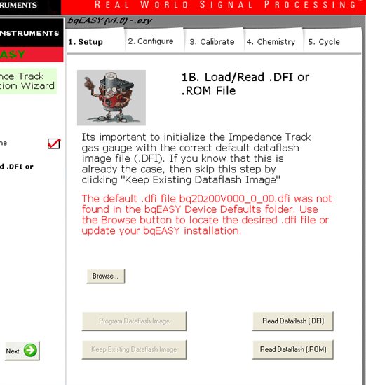

1). While programming default .dfi file it showed error.
2). When I gave path to "bq20z75_1_80.dfi" in Device Default folder & try to program it, it showed error. What is the solution for that.

Did you download and install the bqEVSW from the bq20z75-180 website? It will setup all of the default files that you should need.
Tom
Tom,
yes I had downloaded it from TI website. You can see it in above picture, version is v1.8. But still got error in the same.

I would try running the setup file again, because the dfi file should have been extracted and loaded. Here it is, in case that does not work.
Tom
