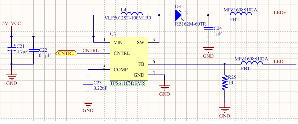

    We are using TPS61165DBVR in our design for a LCD back light. We are using control pin as enable ( No brightness control) and it is 3.3V from a IO of a processor. Input voltage is 5V. I have not seen any switching pulse in pin 3. Here is my circuit. I have replace two new Chipset. But so far no result achieved.  Please share your comment.
    Thanks in advance,
    Vijay
  • Hi Vijay,
    Could you tell me about your output voltage?
  • Hi Ming Dai,
    The required output voltage for us is 10V.
    With Regards,
    Vijay
  • Hi Vijay,
    It seems strange, so could you show me some waveforms? I'd like to see the waveforms of Vin, Vcntrl, Vsw and Vo  in start up procedure if you have a four channel scope.
  • Hi Ming Dai,
    Yes it is strange.  Finally it worked by replacing one more new IC. Thank you for your support.
    With Regards,
    Vijay
