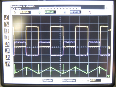

I have a problem with  a POE design I have which follows the application note for the National LM5070. The problem I have is that the transformer primary does not exhibit the normal flyback behavior with a ring above the input voltage, and the current waveform through the FET current sensing resistors is triangular and not zero in the off phase of the FET. Tracking is not exactly optimal but should not really cause this problem as far as i can tell. I have tested my transformer and opto coupler on the development board, and these perform correctly.
Anyone any clue as to what I have missed?
