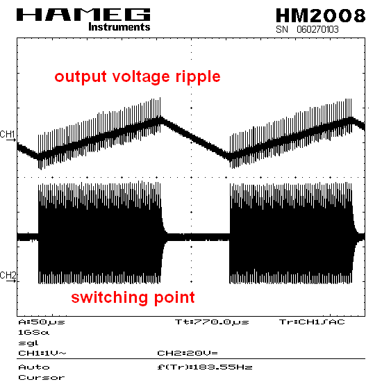

My design comprises a SEPIC stage with 4V5-20V input range and 13.5V output at max. 1A. In most cases the load is significantly lighter, coming down to a 0.5W minimum instead of 13.5W.
In these conditions there is a strange regulation behaviour seen for higher input voltages. Everything is fine for Vin below 16V. At about 16V5 the regulation gets jumpy with noise in the lower kHz-range. Furthermore, the average output voltage rises to 14.5V, meaning, that the feedback input is almost permanently above 1.25V (a voltmeter reads 1.30V average).
I varied in large scales the capacitor at the feedback pin (usually 100pF to GND) and the capacitor-resistor series from COMP to GND, all to no avail. The scene does change as soon as the load increases a little. However: the total load is controlled by uController (turning on/off parts of  the circuit) and is always kept at minimum.
Compare the two images in the attached file with 12V input (everything OK) and 18V (with 2kHz ON/OFF alternation).

  • I will build the same circuit in order to verify the behavior, in the meantime could you please provide me waveforms of switching point and output voltage ripple when the problem occurs?
    I am not sure but it seems like over voltage protection. OVP is sensed at the feedback pin and will cause the mosfet to turn off. With the mosfet off, the output voltage will drop. The LM3478 will begin switching again when the feedback voltage reaches Vfb+(Vovp - Vovp(hys)) (see the datasheet for detail).
    By looking at the switching point there will be some skipped pulses and by changing the amount of output capacitance you will also change the frequency of the ripple.

  • I'm a bit lost, Giuseppe.
    In the file there are the waveforms of which you speak. Do you need them with another resolution, e.g. 1usec/div? Then we do not see the whole picture. Waveform of switching point: is that the Gate Drive?

  • Hi Thomas,
    I have a thought, to me it looks like you are running into minimum on time issues. From your 15k resistor on FA/SD I am guessing your switching frequency is about 850 kHz. With a 325 ns typical minimum on time you can expect it to start pulse skipping at 28% duty cycle. When you are operating in DCM the duty cycle will decrease with your load current. It also makes sense you will see it occuring more at higher input voltages because the duty cycle will be lower then. The estimated duty cycle in the 18 V input, 60 mA your provided should be 26% duty cycle.
    One scope shot that may help as he mentioned is a zoom in of the switching point to measure the on time. I believe he is referring to the node between the input inductor, the switch and the series capacitor.

  • Hello Thomas,
    the images you sent me are about the feedback voltage and the output voltage, in order to understand the problem i'd like to take a look at the switching waveform across the mosfet drain to ground and the output voltage ripple.
    As I said before i am pretty sure that the LM3478 is bursting and the circuits is working in OVP mode since the load current is very low.
    I don't really think it's a minimun on time problem. The duty cycle for a SEPIC converter is defined as D = Vo / (Vi + Vo).
    D = 40% when Vin = 20V --> ton = D/fs = 0.4/800e3 = 500ns
    D = 75% when Vin = 4.5V --> ton = D/fs = 0.75/800e3 = 937ns
    Giuseppe

  • Hello Nyman,
    it seems to me that the LM3478 is working in OVP mode and it is bursting (overvoltagep protection mode). When I say bursting I mean there is not a continuous operation because the part stops switching when the output voltage hits a certain value (please see the datasheet for more details and take a look at the previous posts).
    Could you please provide me the schematic and waveforms about the switching node (drain of the mosfet to GND) and the output voltage?
    Giuseppe
    attached is the schematic as well as some measurements at 15, 20, 25, 30V input, and 24V output with 360 ohm load.
    7762.LM3478_measurements.zip
  • Hello Nyman.
    the part is working on OVP mode as expected. In a previous post I wrote the following:
    OVP is sensed at the feedback pin and will cause the mosfet to turn off. With the mosfet off, the output voltage will drop. The LM3478 will begin switching again when the feedback voltage reaches Vfb+(Vovp - Vovp(hys)) (see the datasheet for detail). By looking at the switching point there will be some skipped pulses and by changing the amount of output capacitance you will also change the frequency of the ripple.
    LM3478 is working in OVP mode and it is bursting (overvoltagep protection mode). When I say bursting I mean there is not a continuous operation because the part stops switching when the output voltage hits a certain value.
    You can verify what i just wrote from the waveforms you sent me:
    This is a normal behavior and it is implemented in order to increase the efficiency at light load.
    If the efficiency at light load is not a problem you could decrease the feedback resistor values such to generate a dump load which keeps the switching action of the LM3478.
    For instance if the top feedback resistor is 100K and the bottom feedback resistor is 10K you could use 10K for the top and 1K for the bottom. Keep decreasing until you get the desired ripple, anyway you are going to lose in terms of efficiency.
