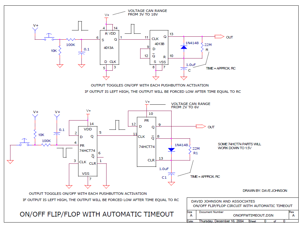

  • I would suggest thinking of each sub-system you will need to accomplish the tasks you desire and then seeing what ICs will meet those needs.  For example, you will need a dc/dc converter to convert the power and an MSP430 to do the 16 second monitoring function.
    For the dc/dc, the TPS63060 might be a good start to look at.
  • Thank you for your input. I honestly feel like this is way over my head but am I making a guess saying all of these switching regulators have all the safety features I am looking for already built in with all these kinds of variable voltage devices? Also the TPS63060 is almost exactly what I am looking for except the amperage limiting should be at 3.0-3.5 amps. Also are these going to be able to run by themselves or do I need other things to run in conjunction with this DC/DC
  • You will need to read the device's datasheet to know which features it has and doesn't have.  There are many built in.  Some features you mentioned that most regulators will not have are reverse input voltage protection and your 16 second timeout circuit.
    The TPS63060 produces a programmed output voltage when given an input voltage.  It can run on its own.
  • A blocking diode will help protect the circuit from someone reversing the polarity on accident.
    You could use time out circuit logic modified from the one below, ( from discover circuits.com) to turn off your circuit after a certain amount of time.
