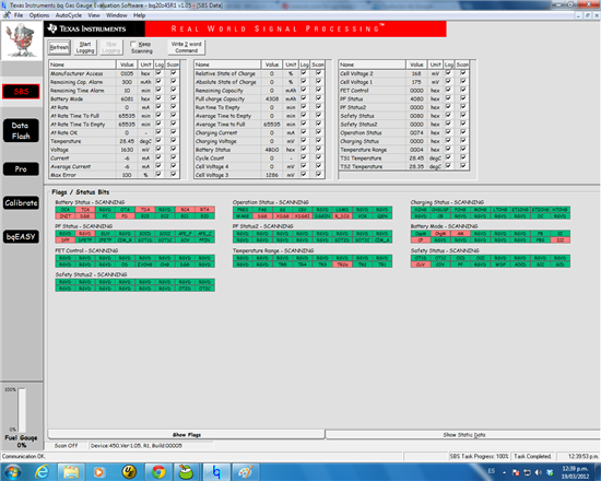

I have a board and I need to configure BQ20Z45EVM. For this I use the BQEASY software (V 1.87). When I press OK on the screen 2H a new screen opens stating: "There is a permanent flag set! Sorry, can not configure DATAFLASH. Please clear the flag and try again."
I can verify that the flag set (in the SBS option the "bq Evaluation Software") are: In the "Battery Status" bits: TCA, TDA, RCA, RTA, INIT, DSG and FD In the "PF Status" bits: RSVD And DFF In the "Operation Status" bits: DSG, XDSG, XDAGI And R_DIS In the "Temperature Range" bits: TR2A In the "Battery Mode" bits: CHM, AM, CF and ICC In the "Safety Status" CUV bits.

  • The bqEasy software for bq20z45 is pretty buggy; therefore, I don't recommend using it. You will be better off utilizing the help text to manually configure the DF parameters. The help text can be accessed by right-clicking on a parameter in the data flash screen of EVSW.
    Unfortunately with this device you have a DFF. The only way to recover that is going to be to reprogram the gauge. The most common cause of a DFF is if a DFI file for a different firmware version is programmed on the gauge.
    To reprogram the gauge you will need to:
    1) Go to ROM mode. Send command 0F00 to command 00 using Pro screen.
    2) Program the attached SENC file using the Srec Programming section in the Pro screen.
    3) Once programming is finished, send command 08 under the Send SMB Command section of Pro screen.
    SLUA404 is a document that will help walk you through configuration, calibration, golden learning, etc.
