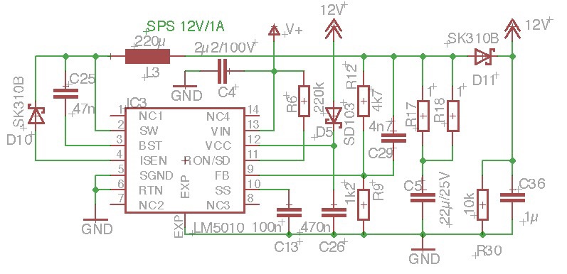

I've designed a DC/DC converter from 48V to 12V using LM5010.
The output gives just about 7V, which breakes down to about 3V when I connect an 1kΩ resistor.
I tested it with two chips (to see if one is defective) an tried to change some resistor values - no success.
Voltage on FB-Pin never reaches 2.5V (<1.5V measured with oscilloscope).
Similar designs with LM5007 and LM5008 are working without problems.
Please see the attached drawings...

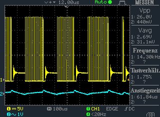

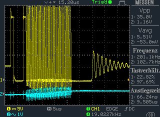

    Now oscilloscope pictures (input voltage = 25VDC):
    Ch1 = @cathode of D10 / left side of L3; Ch2 = AC part of Vout
    Pict. 1: open output, DC-level = 5.5V
    Pict. 2: Same as 1 but central pulse strechted
    Pict. 3: 100Ω connected @ output; DC-level down to 2.5V
  • Hi Thomas,
    I don't see anything wrong in the schematic. I would go back and check all the values and connections.
  • BTW, it is possible to remove C36 and all other capacitors downstream. I want to make sure that the converter is getting enough ripple.
  • BTW did you try removing D5?
  • Hi Thomas,
    Is it possible that because of some wrong connection the output is not connected? For example output capacitor not connected. Or R17/R18 are stuffed wrong so that there is no connection to the output capacitor or the load. May I request you to check that?
