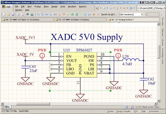

I am having a low output voltage issue with a TPS61027 we have designed into a new product, that is ready to go into production. Since this is a fixed voltage charge pump, there are no feedback resistors I can play with. I think all that is left is the inductor. The markings on the part seem to indicate the proper device. The inductor we are using is a 4.7uH NR3015T4R7M, and I am including a schematic below.
There is no load on the supply, it is attached to an external connector to supply a utility 5V for any potential external devices.
 I checked the output with an ohm meter and it shows >500K Ohms, both polarities.
 I note that there is mention of needing a minimum ESR, is this still true? Is there a recommended output cap that will fit, and make this work? Might I need a minimum load to make the device function properly?
The layout is very tight, with fat traces to everything.
This is very urgent for us as we are about to go into production. Your help is very Appreciated!

    Your inductor only has a saturation current rating of 1A.  This is likely an issue with this part which has a 1.5A switch current limit.  You need to check, based on your output power, what current the inductor needs to handle.

    We need to make sure you are using the IC in a recommended configuration.  Then, we can evaluate the output voltage it gives.  You need to add some ESR to your output cap to bring it within the part's requirements.  I would replace your Cout with a 2.2uF ceramic in parallel with a tantalum cap with ~80 mOhm ESR.  You should also disconnect anything downstream of the IC to isolate it from other components.
    With only 150 mA load, I would highly recommend the smaller TPS61070 or TPS61240 over this IC.  You generally want to use an IC that can provide your maximum output current plus a little extra--not 5 or 6 times what you need.  In fault conditions, your board, traces, inductor, etc. are better suited to the lower current offered by smaller ICs.

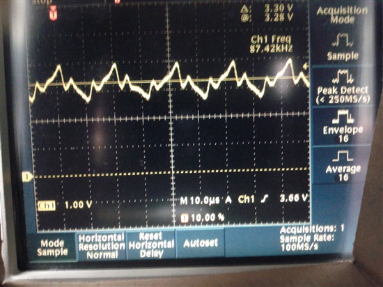

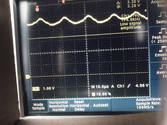

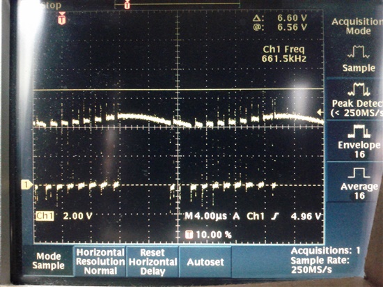

  • Hi Chris,
    I took some pictures... hopefully this will help... let me know if you don't get them...
    The first is the sw pin, second the Vbat pin, third the Vout pin.
    I will try the PS pin next, then try replacing the ceramics.
    Thanks much,
    Bill
  • Thank you!  The pictures came through great.  You have a low frequency oscillation on the output which is symptomatic of control loop instability.  Also, your input is moving around quite a bit.  It's not clear if this is originating from the output voltage.
    Both those tests would be good to run.  You might also try adding a large input cap (100uF for example) to try and keep the input stabler.
