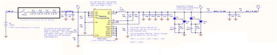

  • This kind of noise from the power supply can usually be fixed with external component selection.  Thank you for posting a schematic but it is unreadable as it is too small.  Could you re-attach a pdf?

    This is part of an intrinsically safe device, so the requirement of the resistors and crowbars are a requirement.  Also I am not able to increase the inductance on the board or the capacitance at the input of the buck.
    Hopefully this pdf version will appear better?   Let me know if it is still not clear.
    0511.tps62113 sch.pdf
  • Your safety requirements are understood.  Since you're not using the LBI function, I would highly recommend that you use one of the newer devices that I mentioned.  The control method is better and they allow for smaller external components.  They also have multiple device versions available, fixed and adjustable.
    I would need to see waveforms of Vin, SW, and Vout to comment further but it is likely that you have too much source impedance--too much R and not enough Cin.  Do you have to have all that Cout?

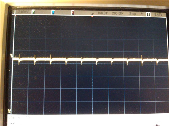

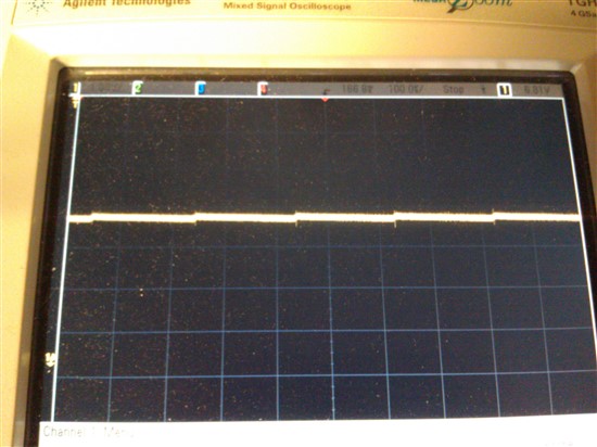

    I have some quick pics snapped from the scope.  I can upload better ones if these don't provide sufficient info.
    VIN
    SW
    VOUT
  • These waveforms are sufficient.  What is the frequency of the SW node?  The IC is likely operating in the audible range due to your light load.
    Removing a lot of your Cout or operating the IC in forced PWM mode should eliminate the issue.

    I checked the frequency this morning of the SW waveform, and it is 4.5 kHz, which would explain the sound.  Operating in the forced PWM wouldn't be a good option for us, as we're relying on the low-power aspect of the chip while running a minimal load (the sleep mode of the device is about 25uA), but we need this rail to be powered at all times.
