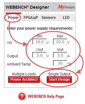

  • I suggest that you use the WEBENCH web site as it will give you far better comparisons, along with schematics, BOM, etc, that what I can possibly convey via email.
    http://www.ti.com/ww/en/analog/webench/power.shtml
    In the WEBENCH tool, click on the 'Power' tab, enter the power supply requirements, then click on 'Start Design'

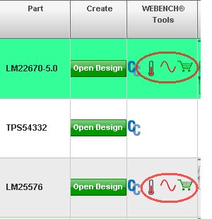

  • Too bad you did not select a part # that has the WEBENCH Tools to answer your questions.
    I suggest that you post your specific questions for the TPS54332 in the 'Power Management > Non-Isolated DC/DC' support forum to get an answer from the  TPS54332 experts ...
    http://e2e.ti.com/support/power_management/non-isolated_dcdc/default.aspx
