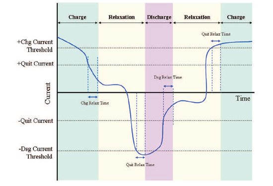

Update of RM and FCC takes place after each resistance grid-point update, at the end of discharge, and at the exit of relaxation mode.
Please teach me the end of discharge condition.
Is the condition detection of terminate voltage?

Hello Kohei,
End if discharge is when the current detected by the gauge becomes less than the Quit Current (Defined in data flash, you can refer to the data flash summary found in our datasheets) for longer than the Quit Relax Time (also defined in data flash). The diagram below shows the various modes the gauge will get into based on the current thresholds and times defined in data flash. I hope this helps.
