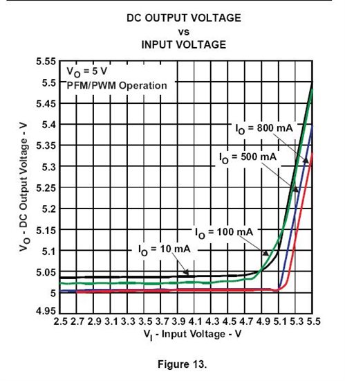

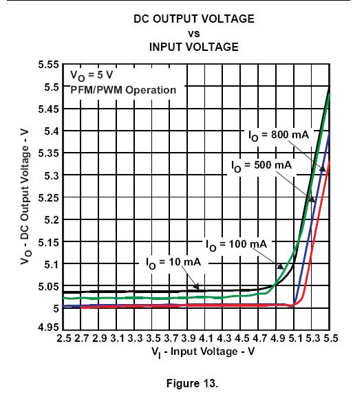

    This question is answered in the datasheet, page 17.  This section describes that the IC can enter 0 duty cycle mode and not boost the input voltage if the output gets too high.  It then refers you to figure 13 that shows as Vin rises above Vout, Vout rises with it.  Essentially this is pass through operation.  The IC does not shutdown, it simply stops switching and does not boost the output further above the setpoint.  This is safe for the IC and it can supply the rated current so long as there is thermal fault due to excessive losses in the IC and assuming EN = 1.

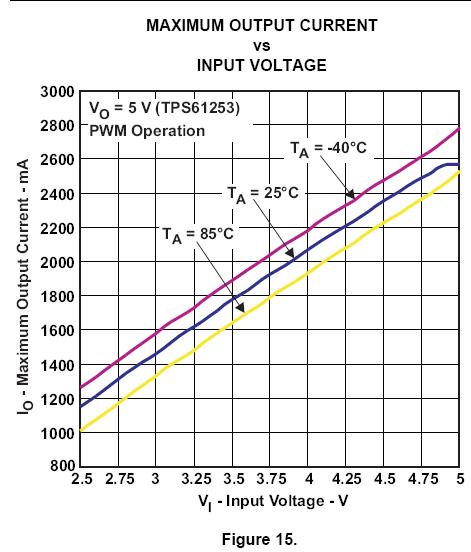

    1. If I made up my board with applying recommended condition in the datasheet, then is it OK 1A continously?
    2. TPS61253 Evaluation Board can generate 1A continously without thermal fault?
       Or need to other action for 1A continously?
    Would you tell me about it?

    Yes, the part can support 1A current as shown by the efficiency figures in the datasheet and figure 15.  A thermal fault is only a concern if you do a poor layout.  By copying the layout of the EVM, which s also shown in the datasheet, you can avoid this from happening.

    Please let me ask about output current capability at zero duty cycle operation. I'm not sure why Fig.11 show graph of Io=500mA and 800mA though there is following description in page 14.
    • Therefore the output can be kept as close as possible to its regulation limits even though the converter is subject to an input voltage that tends to be excessive. In this operation mode, the output current capability of the regulator is limited to ca. 150mA.
    Can you explain the meaning of 150mA in this description?

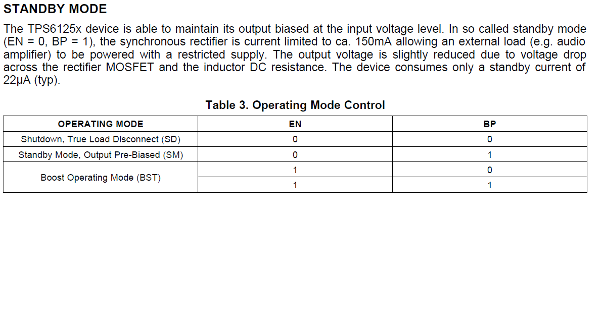

  • Hi Sonoki,
    Let me answer your question, 150mA means standby mode current , not Boost operation current.Please check the table 3 in datasheet in detail:

    I believe that the output current draw from only PMOS at zero duty operation, then the maximum load current will be 1.8A at zero duty operation? I know that the junction temp should be care.
    Sonoki
  • Where did you get 1.8A?could you please post the screen shot where you get it?
  • Hi Chen,
    I referred abs max of Continuous average current into SW. Please let me know the correct value if I do not refer correct information.
    Sonoki
  • Yes, in this condition, Vin=Vo. Iomax ≈ 1.8A
