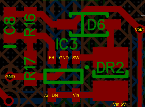

I've been trying to get the LM27313 to work in my application without any positive result. The circuit is done as suggested in datasheet, 5Vin to 12Vout, with slightly different resistor values for the feedback. However when applying a nice low ripple 5V the IC seems never to start switching the voltage as the output is 5V - ~0.3V = 4.7/4.8V. On the SW-pin I see no action at all, it's voltage is exactly the same as Vin without any measureable switching. The FB-pin is as low as 0.5V where it, according to datasheet, should be around 1.23V.
So in order to rule out any problem with faulty/destroyed IC, wrong voltage divider for feedback or anything else I made a new application circuit exactly as described in datasheet, new fresh LM27313 and with the recommended components. However this made no difference as all the voltage levels are the same as when measured on board my main application pcb. As far as I can see with my scope is that the IC never starts switching and stepping up the Vout for some, to me unkown, reason. Power supply in both cases were a stable low ripple 5V/3A.

  • Hello Andreas,
    it may be a layout issue, could you provide your layout?
    You can also try to mount the LM27313 on a LM2731/3 EVAL BOARD since they are pin to pin compatible.
    Giuseppe

  • Due to certain restrictions Im only allowed to attach the part of layout where the LM27313 is used. One thing that comes into my mind is if the GND-pin has too long trace to the actual GND plane but still the total length of that particular trace is 5,36mm.
    Below are the component values of which I used on my main application pcb.
    Vin = Powersupply 5V/3A
    R16 = 150k 1%
    R17 = 18k 1%
    C8 = 220pF X5R
    D6 = 40V/1A schottky (SKL14 from diotec.com)
    DR2 = 10uH/1,1A
    Cvin = 10uF/35V X7R (out of picture but is 1,4mm from the yellow text 'Vin 5V')
    Cvout = 10uF/35V X7R (out of picture but is 0,8mm from the yellow text 'Vout')
  • Andreas,
    Thank you for sending the layout. I don't see anything that would cause such a severe problem.
    I can only guess that the part must be damaged in some way at power up. It is possible that there is overshoot on Vin.
    Can you monitor the VIN and SW voltages at startup and send me a scope capture?
    Thanks and regards,
    Allan
