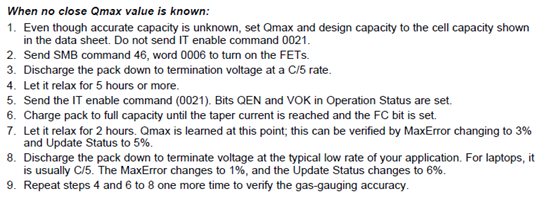

  • The most likely reason for no charge or discharge current is that you haven't enabled Impedance Track. Also, make sure the Sys Pres pin is grounded if you are using the pack in removable mode. Here is the procedure for the learning cycle. Where is says to send command 0021, the address is 00. Update Status will change to either 06 or 0E if the learning cycle is successful.
    Both calibration settings and golden settings persist through power cycles. The settings are all stored in data flash.
    You will need to get the thermistor working before doing a learning cycle. The thermistor does need to be attached to the cells. A high reading of 128C indicates that the thermistor is shorted out, so you will need to look in to why that is.
