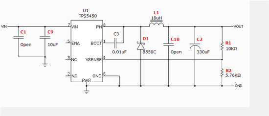

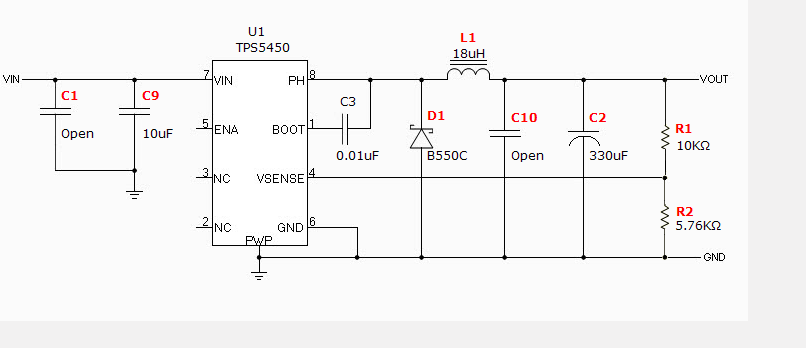

I have used TPS 5450 to generated +15V, +5V and +3.3V, the input is +24V.
All those three circuits are using the same circuit as attached image.
The problem is +3.3V out of regulation after a while and become +4V.
I have replaced the TPS5450 for +3.3V circuit and it repeated the same problem after a while again.
+15V and +5V circuit didn’t have problem so far.
Please let me know what is the reason for this problem.
