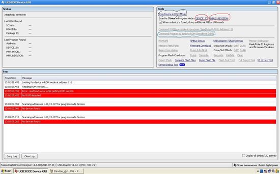

       I'm unknowingly dumped/downloaded  program with checksum into flash memory of ucd30xx ic.how i can reprogram the same device using Fusion Digital Power Designer.
How I can detect ROM of Ucd30xx for reprogram a device.please help me to comeout from program flash to ROM.

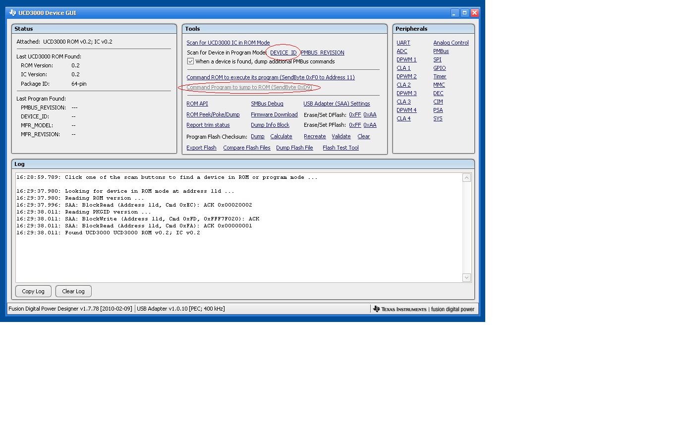

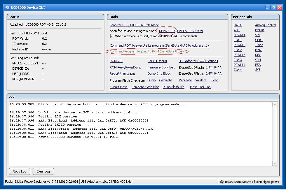

    1. Close any open instances of the Fusion Digital Power Designer
    2. Connect the USB-to-GPIO adapter to the board and apply the input voltage to the UCD3xxx power controllers.
    3. Navigate to Start --> All Programs --> Fusion Digital Power Designer --> Device GUIs --> UCD3000 Device GUI  (it may also appear as UCD3xxx Device GUI depending on GUI version).
  • Last step missing
    4.  Under the Tools section click on Device ID to discover the controller, this should activate the line Command Program to jump to ROM (SendByte 0x09), click this link and the device should be returned to ROM mode.

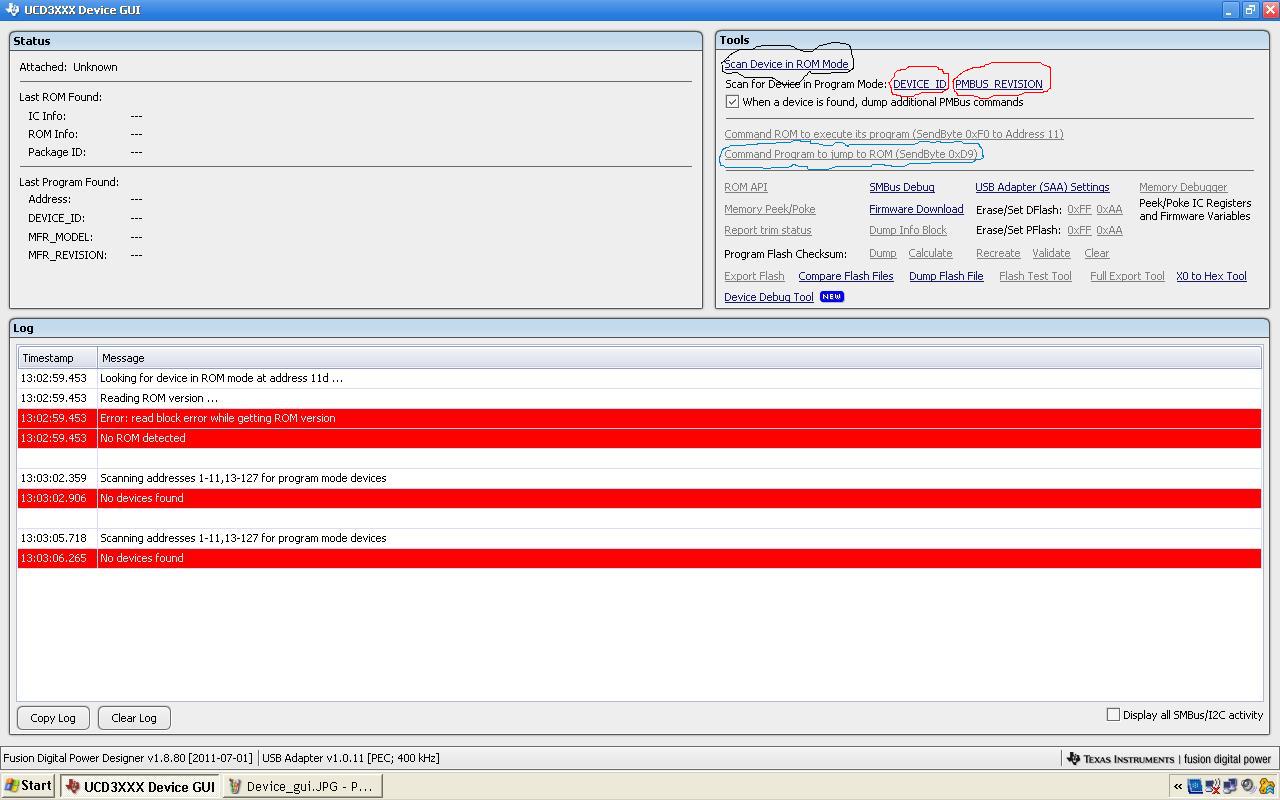

               I tried whatever you suggested but I'm unable to detect a ROM of UCD3020.Your procedure is valid only when program written without valid CHECKSUM.  But programmed with Valid CHECKSUM.
    when I clicked on DEVICE ID it is giving scanning address 1-11 and 13-127 for program mode address.
    No device found.
        and  Command Program to jump to ROM (SendByte 0xD9)is not activated.
    Is there any other way to do this.

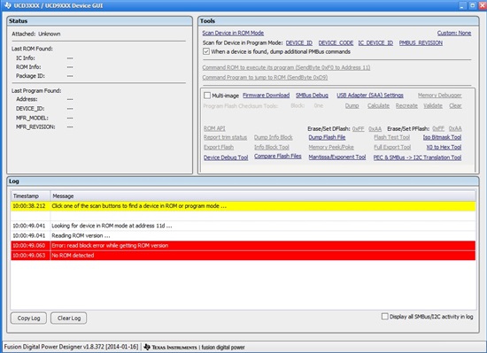

    I was downloaded my Firmware in the target via UCD3xxx & UCD9xxx Device GUI .
    but I lost access to the ROM (ROM not detected) . The following figure shows you what you get when doing a Scan Device in ROM Mode

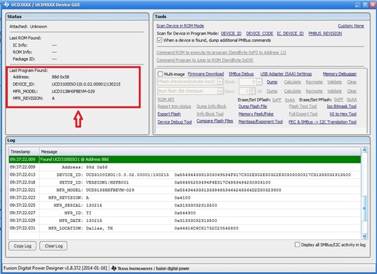

    But when you click Scan For Device in Program Mode we get this:
    At this stage, it is blocked it does not have the right to appoint another Firmware or the possibility of recovering the Flash program. It seems like I was be locked in Flash mode.
    So , How can i get back to ROM mode
