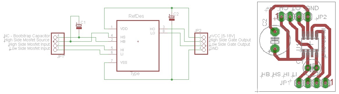

I build a small prototype board just with the chip LM5100 and 2 capacitors, in order to do some tests with MOSFETs and IGBTs.
The current configuration is:
1 - An Arduino is programed to generate and sinusoidal wave (configured by pushbuttons) from 2-100Hz, with commutation frequency also selectable from 1kHz to 4kHz.
2 - The 2 outputs from the Arduino (inverted and non-inverted) of 5V are directly connected to the LM5100 inputs (LI and HI). The LM5100 board has 1 electrolitic 10uF, 63V capacitor between Vdd and Vss, and also a bootstrap electrolitic capacitor of 1uF, 63V between HB and HS.
3 - On the output of the LM5100 I already succesfully tested to directly connected some LEDs, and a pair of IRFZ44N. My plan is to use the configuration to test the limitis of some MOSFET and IGBTs, so later I can build something bigger.
Now my questions:
a - Can I use LM5100 for something more serious like a full bridge PWM controller of a 1000W DC Motor, or a AC inverter for 3Ph Induction Motor? Or it is restricted to DC/DC chargers and rectifiers?!
b - Concerning point 2, I have no idea if I should use electrolic or ceramic capacitors. I know that they should be low ESR... And what about recomended values? the LM5100 datashet has no reference to that.
c - I it correct to assum that an MOSFET Driver can be use without restrictions to drive some IGBTs?!
d - This test board I build just work with the supply voltage between 7 and 11V! Why it can´t reach the 18V indicated in the datasheet!?!? It is an "hand built" PCB, probably with some parasitic currents between tracks... but I imagine that could be relevant only for high frequencies...

  • Try a larger cap for C-boot I suspect that you are losing the high-side gate charge at that low frequency.
  • You may want to take a look at the LM5041 evaluation board, which includes a LM5101
     , I'm not sure if you are answering directly to my question 4, but both High and Low side outputs of the driver stop working above the 11V, so I think that's not directly related with the bootstrap capacitor?!?
  • Hi Luis,
    You are welcome.
    The resistor and diode make for different behavior during turn on and turn off of the FET
    On turn on, when the driver sources voltage, the gate current is limited by the resistor.
    On turn off, when the driver sinks current, you want to take out the charge on the MOSFET gate as fast as possible, the diode makes a fast (no resistance) discharge path for the gate capacitance.
    I don't know the reason for the 10K. I usually would put a resistance like that to provide a path for self discharge of the gate capacitance when not driving the fet. But I do that when my driver has source capacity but no sink capacity. Since the LM5100 has source and sink capacity, I don't see the need for the 10K resistor.

  • First of all, the device has to work up to 14V, not 18V. Always look at the recommended operating conditions, NOT at the absolute maximum ratings.
    I don't know why it stopped working at 11V, though, and I don't think that it is related to the value of the bootstrap capacitor.
