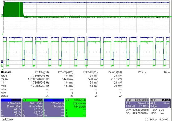

this oscillogram show normal long key pressed and state-machine in scanning state.

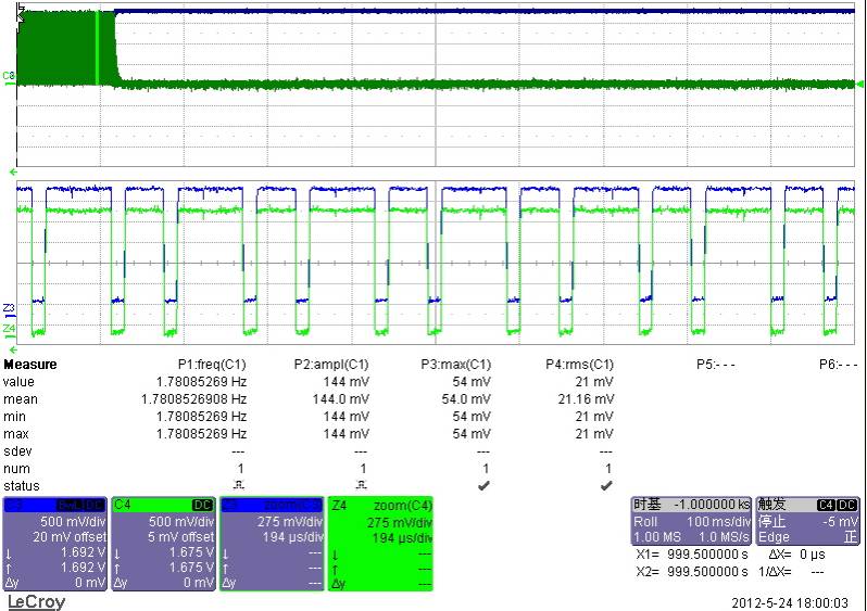

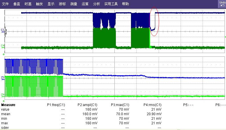

this oscillogram show exceptions with continually hit key quickly!
As we see, before sequencer state-machine going to idle-state, it keeps low level for about 100ms and it's very strange.
I think this issue may be the hardware state-machine's exception ?
