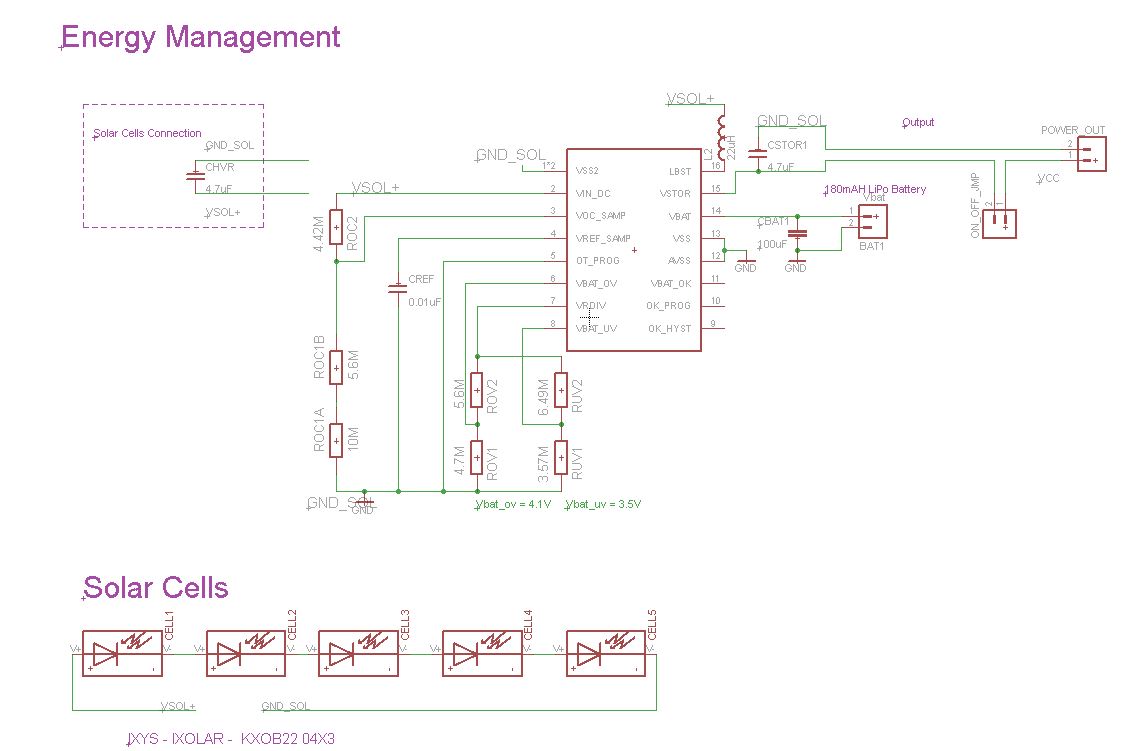

  • I am facing the same mis adventures, unable to charge a Lipo battery with this BQ25504 and KXOB22 Solar Cells ...
    What has been the outcome of your tests ? Could you successfully charge the Lipo battery ?
    I successfully charge the lipo. All the circuit works correctly but I was using a very low intensity light and the module cannot charge. When I used natural light I realize that all was fine. How is your schematics?
  • This is my schematic .. I measured the input current to the LiPo and it is less than 1mA ... which obviously will never charge the battery ...
  • Check the voltage on VIN.  It should be regulating to the percentage of the open circuit voltage that you set with the MPPT resistors.  If not, it could be leakage from the capacitor on the VREF samp pin.

  • These aspects you mention seem a bit far fetched to me as I've never had any experience in this domain but if that is the case I don't know how to continue from here.
    I've ordrered my PCB and they are good quality and then I use a reflow oven to solder the QFN, everything else is hand soldered, flux is added sometimes in small quantities and cleaned afterwards ...
    But I have more the feeling that the output current is limited, nothing near 10mA but closer to 0.1mA ... could it be that the Inductor is undersized ? I have this one : Taiyo Yuden CBC2012T220K which specs are 22UH, 170mA, 10%, 16MHZ so this looks good to me...
    I guess there is no other special requirement when trying to charge a LiPo battery ? I mean If you put 4.1V accross its terminals then the current should be flowing and charging it we no ?
  • Inductor saturation current is a bit low.  Slightly larger than 300mA would best.
    Also, board assembly problem is real.  I make these EVMs for TI and had to rewash an entire batch due to contaminants after assembly.  Large resistors are always a problem.  But that cap on VREF_SAMP is critical to the IC functionality.
    As I mentioned before, check the voltage on VIN.  It should have some ripple but not much, except when the MPPT activates every 16s.

    The voltage on VIN is like a proper DC voltage with little to no ripples at all ...
    A new question came to my mind, for VBat I used a 100uF capacitor in parallel with a LiPo 180mAh  battery, but I tried to remove the capacitor it doesn't charge any better, though the capacitor alone charges well ( probably because even a few uA are enough to charge it quickly ...)
    My VREF_SAMP cap is a 10nF cap nothing special to it ...
  • Regarding the wash, I had to find a special board assembler with the ability to wash to 50Mohm sensitivity.  If the VIN voltage appears to be regulated with low ripple, then the capacitor is not leaking so board wash is not the problem. The capacitor itself should be low leakage so either X7R or COG.  To what voltage does VIN regulate?  Is this voltage the appropriate percentage of VOC that you set per the MPPT resistors?
    Regarding the battery charge current, you mentioned that you only measured about 1mA.  Is there a load on VSTOR that is robbing some of the charge current to VBAT?  The leakage current of the battery itself will look like a dc load on VBAT=VSTOR but if you are measuring current from VBAT into the battery, you would measure that too.

  • I narrowed down my problem to my solar cells .. because I replaced the solar cell with a power supply and everything worked well... I am glad I don't seem to have troubles with the flux or whatever else...
    When testing with that power supply I estimated the efiiciency to be arround 75% .. which is slightly below the specs but reasonable..
