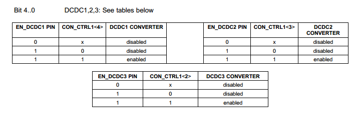

6.  In DS page53 - Con_CTRL1 register bit[4:2] for DCDC1:DCDC3. It is not exactly clear - now these enable bits function.
7.  DCDC2 and DCDC3 are automatically power-up sequencing. So the enable pins for DCDC2 and DCDC3 are tired to GND (page53). "The CON_CTRL1 Bits are automatically reset to default when the corresponding enable pin is low". How to understand that? Does it mean - the DCDC2 and DCDC3 will restart again after being disabled by writing '0' to bit[3:2]. Or according to the Tables on page54 - the state of bit[3:2] don't care?

    I would like to add one more question about CON_CTRL1 register
    The tables on DS page53 show that bits[4:2] are don't care (x) when EN_DCDC1:EN_DCDC3 are '0'. Is it correct?
    That means - the SW can't disable DCDC2:DCDC3 by setting CON_CTRL1[3:2]="00" because pins EN_DCDC2:EN_DCDC3="00" (the SQ2:SQ0="011" for OMAP-L138). Is this true?

  • Boris, will you please provide the volume and application for the TPS65070?
    Per testing in the lab on an EVM, the following tables only apply if the converters are set to enable by the external pins.
    So in your example where CON_CTRL1[7:5] = 011, DCDC2 and DCDC3 can be enabled/disabled using CON_CTRL1[3:2] even if pins EN_DCDC2 and EN_DCDC3 are tied low; in this example, pin EN_DCDC1 would have to be tied high in order for the software to enable/disable using CON_CTRL[4].
    If you are changing CON_CTRL1[7:5] on the fly, in some cases the new power-up sequence must be triggered, e.g. POWER_ON pulled low, then PB_IN pulled low and POWER_ON pulled high then PB_IN released.

    And one question on the TPS65070 DS:
    How should I understand these words from DS?
    "The following tables indicate how the
    enable pins and the CON_CTRL1 register are combined. The CON_CTRL1 Bits are automatically reset to
    Does it mean - the DCDC3 and DCDC2 will recover because "The CON_CTRL1 Bits are automatically reset to
    default when the corresponding enable pin is low"?
    Is it true?
