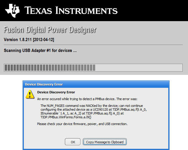

We are using UCD90120 in our board and evaluation module what we have is with chip UCD90124.
Initial days I was able to detect the chip UCD90120 using this module. Now it gives the following error and PMBUS_ALERT LED (D13) is glowing.
But still the evaluation board is working fine with UCD90124 which I received with board. Can you please look into this issue?
For our bulk production pre programming vendor need the file in HEX format. My understanding we have to provide data flash file in Intel HEX format . But HEX file cannot be created in offline mode.
Our current working set up is evaluation module with UCD90124.
Is it possible to generate hex file for UCD90120 using the above combination?
Error message ( Text )
An error occured while trying to detect a PMBus device. The error was:
The NUM_PAGES command was NACKed by the device; can not continue configuring the attached device as a UCD90120A at TIDP.PMBus.aq.f(t A_0, IEnumerable`1 A_1, ac A_2) at TIDP.PMBus.aq.f(j A_0) at TIDP.PMBus.WinForms.Forms.a.l9()
Please check your device firmware, power, and USB connection.
