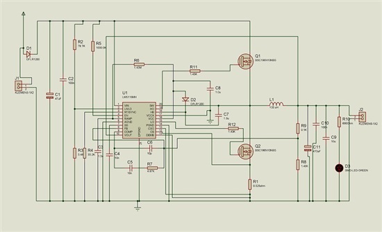

Hi;
I designed a dc-dc converter with using webench that is 36-72VDC input and 9VDC, 2A output. I realize that circuit at own design PCBequal the webench design.
Problem is the circuit works with 30-36VDC input but if the input voltage higher than 39VDC power dc-dc is shut down and never works again. I see LM5116MH pin14 and pin15 near the short circuit (2,5 Ohm) and the dc-dc is fail.
Please, help me to guide for find my mistake.
regards.
  • Hi;
    I solved this problem.
    First of all you must use two resistor (1K aprox.) with from LM5116MH HO(19) and LO(15) to MOSFET gate.
    Second issue is the only one 10uF output filter capasitor is not enough. You must use electrolitic capasitor (100-470 uf aprox.) and 100nF ceramic capasitor.
    After that the dc-dc (attached shematic) works well.
    Regards.

  • Hi Chen,
    I needed 1k resistors because, if LM5116 HO and LO port connected to the Mosfet s gate directly and the input voltage is more than 39VDC the LM5116 is burn. The ic is completely damage and will not be use again. I think, Webench program has some mistake for this point.

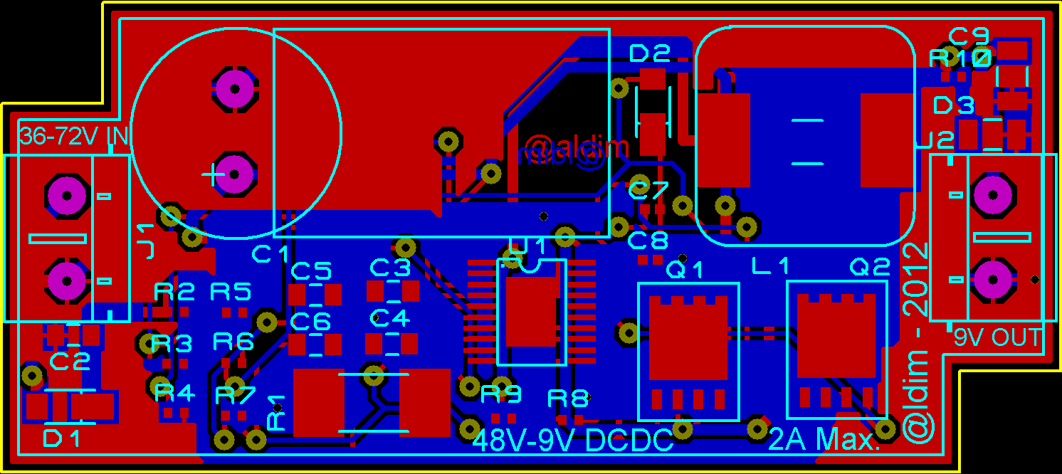

  • Hello Bulent,
    Thank you for the schematics. My interest is to see the layout because that is the critical aspect of the design whether the application circuit performances well or marginal.
    You mentioned the IC was over heating and it stopped functioning. My questions to you are: Was the IC properly soldered down to the PC board and including its exposed pad?  Was your PCB designed with sufficient amount of copper to extract the heat from the IC?   Also, I have looked over your WEBENCH design and it suggests using 2 X 10uF for output capacitance.  Did you use the exact BOM as suggested by WEBENCH?  if not, the performance of the design will be greatly compromised.

  • Hi Howard,
    The PCB layout is attached. I use exact BOM as WEBENCH and i added two ressistors at MOSFET gates and some outpu capasitors with rework. THe ic is properly soldered with exposed pad and is not over heat but, MOSFETs are over heat and i use a cooling element. Unfurtunately, the cooler is not enough. My PCB layout design is not good for this reason. The MOSFETs cooler pads are not enough. This PCB is only protype and i will re design again.
    Thank you, regards.
  • Hello Bulent,
    Thank you for the sharing the PCB layout. You have mentioned that you are looking to redo your layout, attached is my suggestion for positioning the critical components: such as the FETs, Inductor, Rsense and Cin and Cout. We want to make sure the switch node has sufficient amount of thermal vias and copper areas at top and bottom to cool the FETs. And lastly, don’t rout any traces across the switch node or critical traces adjacent to it.
    For the MOSFET overheating issue,  it’s due to the added resistance to the gate.  Here is an equation (Switching Power Loss = Vin * Iout * 0.5 (Trise+Tfall) * Freq) approximating the switching power loss. Using WEBENCH calculated power loss for  M1 is 0.42 and the breakdown of the switching & conduction power losses are respectively  0.41 & 0.01 Watt.   The selected FET theta JA is 62 deg. C/watt and it equates to 56.4 deg. C junction temp with ambient temp of 30 deg C.  If I calculate for Trise/Tfall and it's about 10nS.   Since you have added a 1k resistance to the gate, the rise and fall time will be much slower and I will assume the Tf/Tf is 5x slower ( You can scope this).so then Tr/tf are about 50nS   Now, the switching power loss is almost 5 time more and the junction temp of the FET is close to 163 deg C. This is the reason why your FETs are overheating.
    I would suggest the removal of the added gate resistors and use a RC snubber circuit to help minimize SW node voltage spikes.
    Here is the link for Snubber Circuit Design: http://www.ti.com/ww/en/analog/power_management/snubber_circuit_design.html
    Below is the suggested positions of the key components for you design.
    Howard
