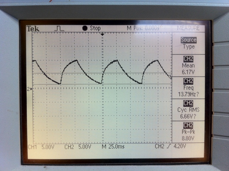

    At the moment I have just tested the external input. If there is no load, the output voltage will vary (around 23~27V depends on the input voltage). If I use a 420R resistor for the load, the output will drop and a typical capacitor charge and discharge waveform can be observed, please refer to the attached screen capture of the output.

  • Your new schematic is much better and seems to match the modify instructions given earlier for the TI TPS23754EVM-420 for 24V output.. TI built and validated those instructions with lab testing so we are confident the circuit is fine. Maybe there is an incorrect resistor value or connection on your test board?
    The waveform above can occur because the TPS23754 converter is cycling. This will occur by design in an output overload condition and is referred to as "hiccup". This can also occur when there is an issue with the auxiliary bias voltage (at the Vc pin). Check R201, D202 circuits and measure that voltage with a) no load and b) loaded as above. THis dc voltage should be at ~12V under normal circumstances (below 9V will shut off the converter and converter will restart when Vc is above 15V (~6V hysteresis).
    I would also suggest using several ceramic capacitors on the output (at C205 location). I suggest 3x 10uF 50V ceramics.
  • Eric, you are right, I found that the TPS23754 and the Vc pin are cycling. I found that it is because the soldering pads of the optocoupler on the PCB were swapped. After I fixed it, the output is at 24V for no load or very small load (below 100mA). However, the ripple output voltage is high (around 1.5V). Also when I increase the load to about 100mA, the voltage drop significantly.
