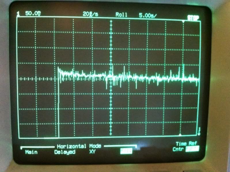

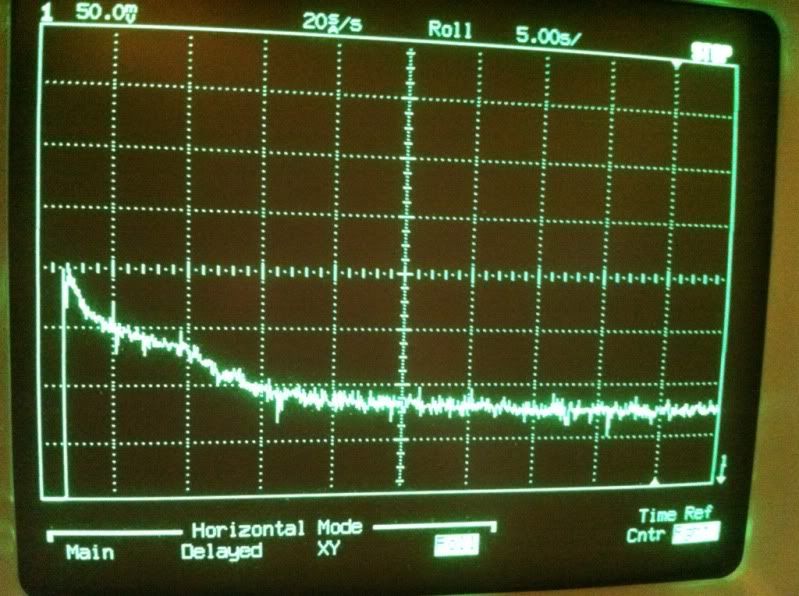

I am seeing Vout start high and then drift down over a 10 second period when driving 3A to the load.  (LED).
If I hit the converter with freeze spray I see the output come down even farther.  If I probe the fb node it appears to be steady around 0.8V during these periods.
DC offset approximately 3.2V.  (Vf of a Cree XM-L mounted on a large heat sink).  Also, I've tied fsw to Vout.  So, it may start out at 2.5MHz and then switch to 1.25MHz as soon as Vout rises.  Don't know if that is an issue or not.  WIsh I could tie it to Vin, but, Vin could be as high as 9V in this case exceeding fsw voltage specification.

    I'm not sure what the waveform is of.  Is it the output voltage of the IC (voltage at VOS pin)?  Since the FB voltage is 0.8V, then the IC is doing its job and regulating.  It's likely just that the forward voltage of the LED starts higher and gets lower as it heats up.  Diode's forward voltages decrease with increasing temperature.
  • Yes, the waveform is Vout.  I have characterized this LED and have many many scope traces at 3A.  I've been troubleshooting the other converter IC issue for over 2 mo's now and know what the Vf drop is and the resulting scope trace should be.  Since the LED is mounted to a large heat sink the rise on the LED over this 50 second period is  relatively small.  Yes, possibly some of this is the VF, but, you see it levels off and is basically flat.  If the LED really was heating up it would continue to rise over this 50 second period.    Besides.  The VF is a negative temp coefficient.  If LED heats up, VF goes down and with a constant voltage applied current goes up.
    The start of this run the LED current was 3.5A and as Vout decayed down LED current leveled off to just tad over 3A.
    The first couple of seconds starting high and decaying is typical of this configuration since I am injecting a PWM signal into the fb node to control the output voltage.  The time constant of the PWM filter network is around 16mS or so and I don't think can account for a 10 second decay.
    As i mentioned in the first post if I hit the converter with freeze spray Vout drops some 50mV.  When I was probling the fb pin and hit the converter with freeze spray I didn't see any change.  Maybe, the scale of 50mV/div was not low enough to see fb change.  (assuming the internal reference changed).
    Is there are graph of the internal reference voltage vs temperature?  I don't think it is in the datasheet.
    If this is the "normal" we can work around it.  Currently the servo current routine is turned off so we can monitor the drift of the converter and see if it burps or hiccups that would cause any flashing or flickering as that was the issue with the ST IC.  I believe I have traced that issue to noise on the internal reference.  I am hoping we don't have the same issues with the TPS62130.

    Here is the EVM with the same LED hookup up to it.  At 3.3V the LED is drawing around 1.8A.  The amplitude and the amount of decay might be larger if it the load was 3A.
