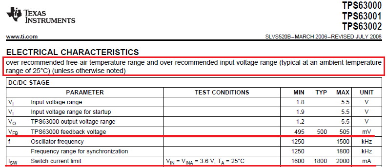

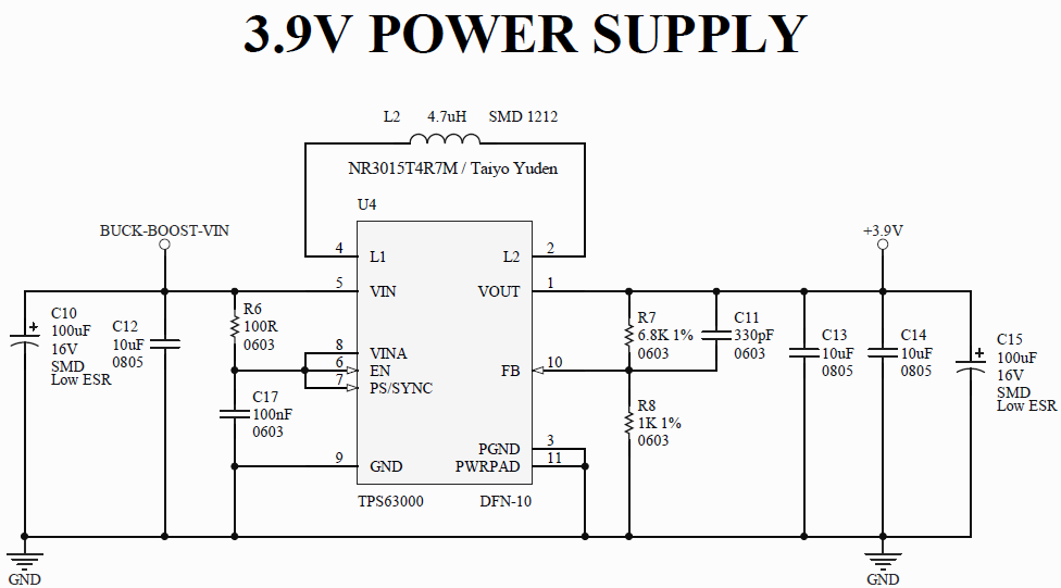

Hi.
I am working on a new desing where I have a TPS63000.
My question is simple:
What should be the following specifications, for the TPS63000, considering it will operate in a temperature range of –40°C to 85°C? The datasheet only shows the specs @ 25°C......
- VFB TPS63000 feedback voltage (–40°C to 85°C) (MIN / MAX)?
- ISW Switch current limit (–40°C to 85°C) (MIN / MAX)?
Pictures of the datasheet and schematic below.
Best regards.
