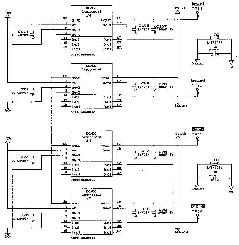

Please let me know about DCP020505 Vout and test circuit.
Guru 19645 points
Other Parts Discussed in Thread: DCP020505
When DCP020505 was tested, Vout became higher than a data sheet.
If the portion which causes a high-Vout with an attached circuit diagram, and a mistake occur, please let me know.
A circuit is parallel, and is using two devices and an input is set to 5V.
A test result is the following.
No load --- 5.74V
100Ω --- 5.64V (56mA)
50Ω --- 5.57V (111mA)
33Ω --- 5.51V (172mA)
22Ω --- 5.41V (246mA)
※I am sorry for a circuit diagram hard to see.
Please contact me, if there is information which is not known.
  • DCP020505 is an unregulated converter. The output voltage varies with changes to output voltage( Vout)  load  and input line voltage(Vin) for each converter. .
    The output voltage  range for each DCP020505 is  determined by both vin and vout load.:
    Defined output voltage at 75% load for (1) DCP020505  is: (each separate DCP20505 with 5V0  +/-0.5% input voltage  and 75% load  (1.5W  at  300mA) , the output voltage range is 4.75V to 5.25V.
    1. The load for two(2) parallel DCP020505 with exactly 5V0 +/-0.5% input voltage to meet the typical Vout (5V0+/-5%) at 75% current  load range is typically 400mA to 625mA .
