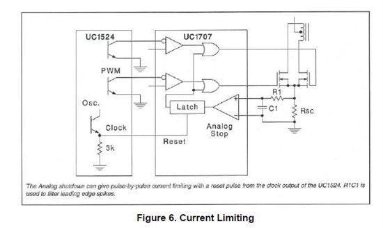

I connectted  the input of uc2709 to the output of a cpld. Both the uc2709 and the cpld was damaged.
I then placed a resistor of 51K between the cpld and uc2709. Uc2709 was damaged but cpld not.
i wonder if  i can apply a voltage on the input of uc2709.
or I should use a open collector gate like 7406 (but without a pull up resistor) to drive it?

    i saw a picture in uc1707's datasheet. so i guess if i should drive UC2709 with a open collector gate?
    If I let the input pin float, output is low.  If I connect the input to gnd, output goes high.
    but i have not tested drive Uc2709 with a 7406.
