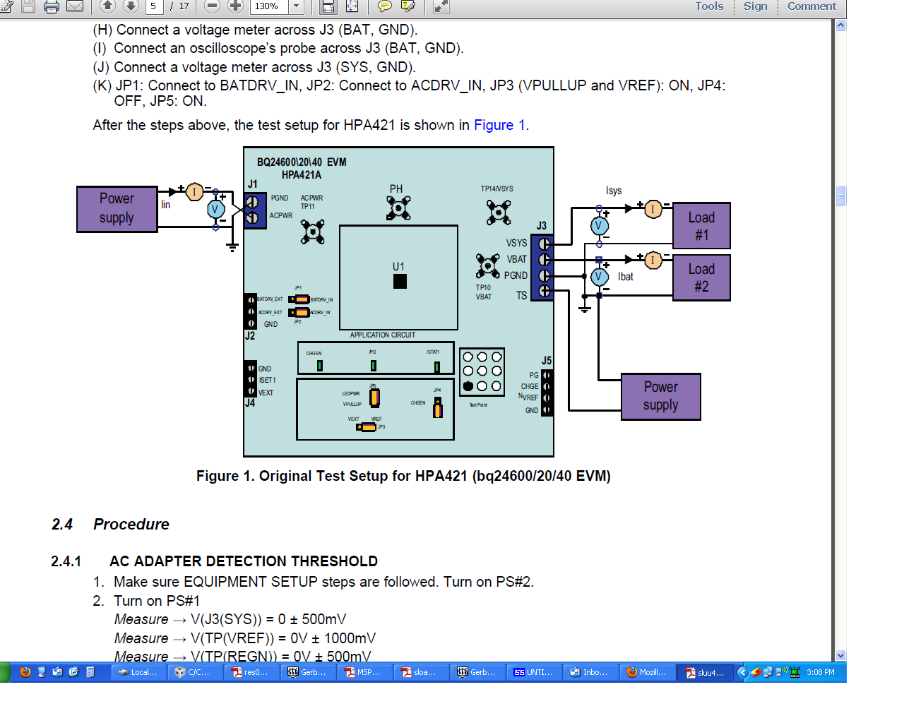

Hello! I selected bq24620 charger for one of my application. I got EVM of bq24620, but there is amazing input/output connections. As from my past experience on chargers on which i worked there is simple input/ output connections( bq2004/bq 2954) . But in this charger i am getting confused that two power supplies used .I here by attaching the snapshot of connection of EVM. So kindly help me out that how connections are being done when I am charging battery from it.
