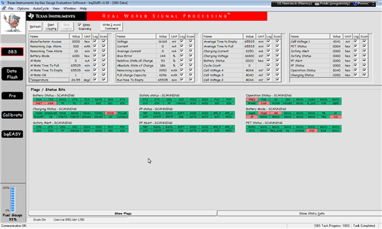

Hello, I have problem with bq20z95 when I fully charged battery i can't discharge it - DSG
transistor is opened. Is this possible because I have max error>144%? Next question how

  • It is more likely the DSG FET is opened due to a safety fault. Check the Safety status and PF Status register to see if any of the flag is set.
    See the link here regarding Max Error = 144%: http://e2e.ti.com/support/power_management/battery_management/f/180/t/30964.aspx#107825

  • Thanks. Screen from bqEVSW, as you can see battery is almost fully charged and DSG FET is turn off. I can't discharge it, I have to send cmd 46 6 to activate DSG transistor. What with second part of my question ? Is it possible to skip some steps from bqeasy and jump directly to cycle when I have programmed bq but on other PC or everything should be done on one PC from the begining Setup->Configure->Calibrate->Chemistry->Cycle.
  • You need to enable IT in order to allow the FW to have fully control of the FETs.
    IT should also be enabled during learning cycle, otherwise, Qmax and Ra table will not be updated - nothing is learned.
    You have a max error of 144. I would recommend re-programming with a default senc from the product web site (http://www.ti.com/litv/zip/sluc123), and then follow bqEASY from the beginning. You should NOT skip any step in bqEASY if you want to use tool to generate a golden image for you. You can choose to skip steps only if you are familiar of how to generate the golden image manually (and want to do it manually) and are very familiar of the device and its various file types.
    However, you can skip step 1B in bqEASY if you re-program the device with default senc file. There is no need to program the default data flash image (DFI) since you already start with a default.
