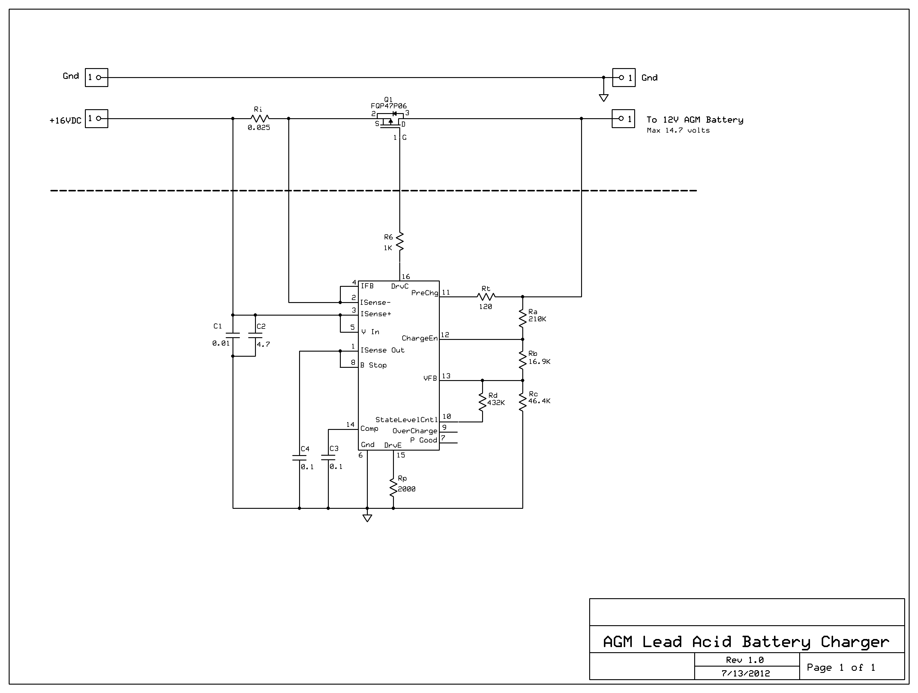

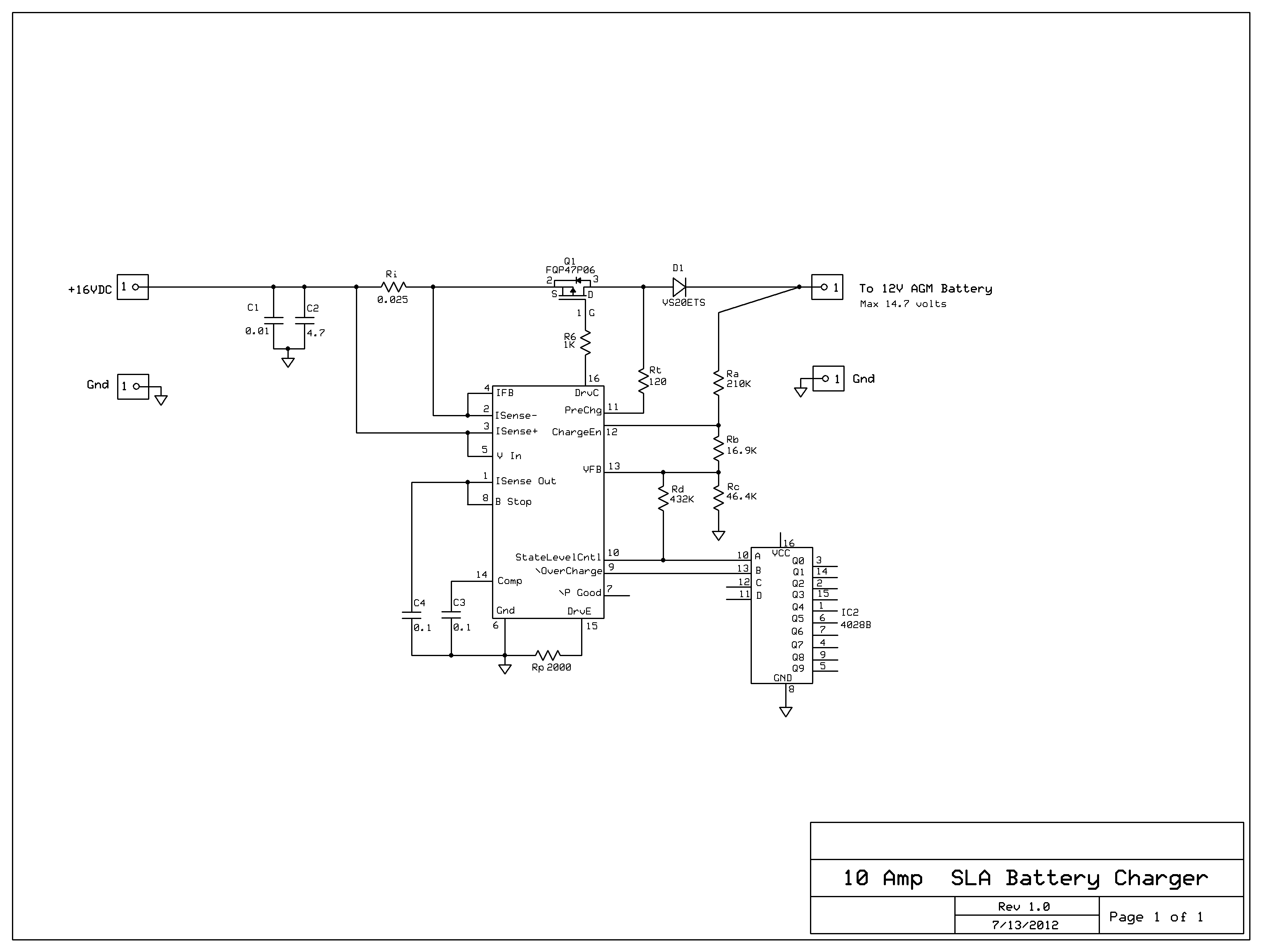

I wonder if you could comment on my design for a 10 amp charger for a 12 volt SLA battery.  It will be AC powered with a DC input of 16 volts when the AC is 115 VAC.
Other design parameters are fast charge at 14.7 volts, float at 13.5 volts, and final discharge of 10.5 volts.
I am also interested in any comments on my selection of the FQP47P06 as a pass element.
Also do I really need D1 since the battery is over 100AH, the discharge thru the circuitry is trivial?
I am also not sure about the values for Rt and Rp.  I calculated the value for Rp from the evaluation module notes.
I calculated Rt based on:  It = Vin - Vt - Vdrop/Rt,  where It = .025 amps.

    The nature of the subject makes it somewhat difficult to verify a design without possible damage to an expensive battery, so any and all comments will be appreciated.
    Pertinent parameters of the FQP47P06 are:
    60V P-Channel MOSFET
    Absolute Maximum Ratings TC = 25°C unless otherwise noted
    Drain-Source Voltage -60 V
    Drain Current - Continuous (TC = 25°C) -47 A   - Continuous (TC = 100°C) -33.2 A
    Drain Current - Pulsed  -188 A
    Gate-Source Voltage ± 25 V
    Single Pulsed Avalanche Energy 820 mJ
    Avalanche Current (Note 1) -47 A
    Repetitive Avalanche Energy (Note 1) 16 mJ
    Peak Diode Recovery dv/dt (Note 3) -7.0 V/ns
    PD Power Dissipation (TC = 25°C) 160 W   - Derate above 25°C 1.06 W/°C
    Off Characteristics
    Drain-Source Breakdown Voltage VGS = 0 V, ID = -250 μA -60 -- -- V
    Zero Gate Voltage Drain Current   VDS = -60 V, VGS = 0 V -- -- -1 μA    VDS = -48 V, TC = 150°C -- -- -10 μA
    On Characteristics
    Gate Threshold Voltage VDS = VGS, ID = -250 μA -2.0 -- -4.0 V
    Static Drain-Source On-Resistance VGS = -10 V, ID = -23.5 A -- 0.021 0.026 Ω
    Forward Transconductance VDS = -30 V, ID = -23.5 A -- 21 -- S

  • Pat,
    Did you ever get your issue resolved?  I am trying to design a charger using a PFET and there is not very good information out there.  In looking at your design I have the following questions:
    How did you calculate a value for Rp?
    Do you not need a Dext because of the diode in the PFET?
    Does the PFET shut off properly or did you need to add a resistor between the Gate and Source?
    Mike.
