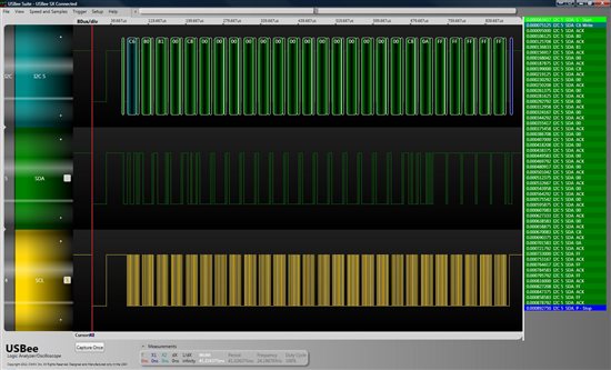

As part of my fault-finding, I have stripped the code back and have removed all but one TLC59116 device from my board and it is configured as:
A0 = 0
A1 = 0
A2 = 1
A3 = 0
So a write will be: 0b11001000 = 0xC8
And a read will be: 0b11001001 = 0xC9
The control register should be set to auto-inrement all registers starting from register 0b0000.
Mode1 register has 100 for the auto-increment, not sure if this matters since it is a read-only register? OSC = ON, ignore subaddr, listen to all-call.
Mode2 register has error status enabled, Group Control = dimming, outputs change on stop.
My test board has all 16 outputs connected, but the final product has only 14 so for the purposes of testing I have LED0, 13, 15, ON at full brightness.
I can see all the above data going out, and can even read back all registers and see the GRPPWM register saying it has the value 10 stored in it... If I change the DMBLNK to '1', the outputs will blink (when GRPFREQ is set lower) which proves the LEDOUT options are set correctly, ie responds to dimming/blinking. At the moment all the code is doing is sending the initialisation, and then either some test data, or doing a read back depending on my testing.
I did come across another thread talking about issues with the GRPPWM which had no answer:
http://e2e.ti.com/support/power_management/led_driverslcd_bias/f/192/t/153172.aspx
Are there any differences (other than more outputs) between the 8-channel TLC59108 and 16-channel TLC59116, I did not come across anything in the datasheet?
Can anyone provide any insight into what could be going wrong? If needed I can provide a I2C trace of the data going out/in.

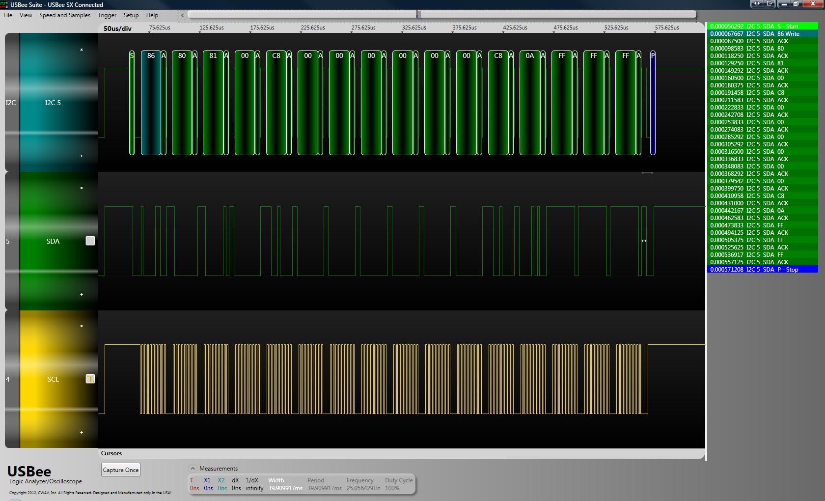

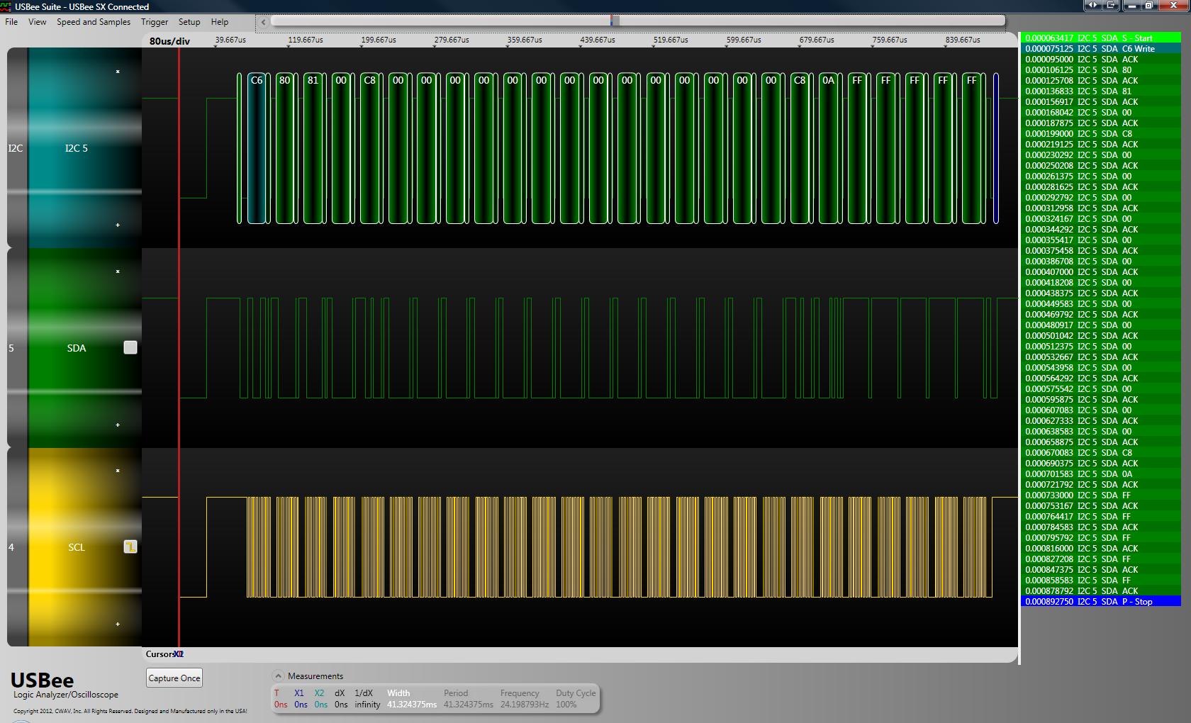

  • Hi Dick,
    Thanks for looking into this. I have just done a further comparison between the 08 and 16. I modified my code to send out the initialisation only for the 08 and then the 16 and captured the I2C. They are still on seperate channels, though I don't think this should affect the results. I've inserted the files below, unfortunately the insert file seems to be inserting as an image. I didn't reduce the size to try keep the text readable, so appologies if they are quite large.
    I changed the address of the TLC59116 to match (A0-A2) that of the TLC59108. As you can see the messages are basically identical other than 08/16 address, and number of LEDs. Only the first and last LEDs are set to 200 (decimal), and the dimming value is set to 10 (decimal). On my test boards both visually and with a scope I can see the TLC59108 very dim, but the TLC59116 has not dimmed at all.
    Do you know what the changes were between the TLC59108 amd TLC59116? Is it possible that there is more than one revision of the TLC59116 in existance?
