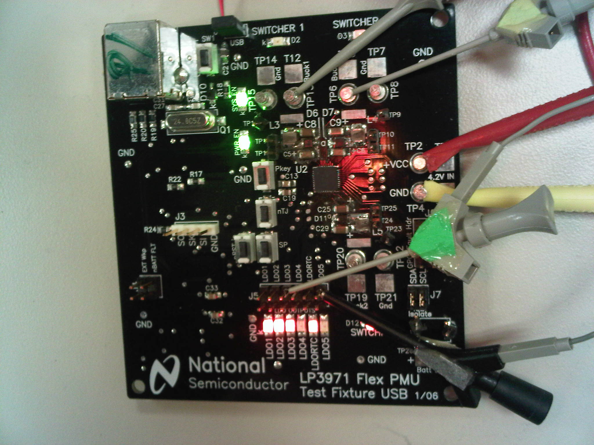

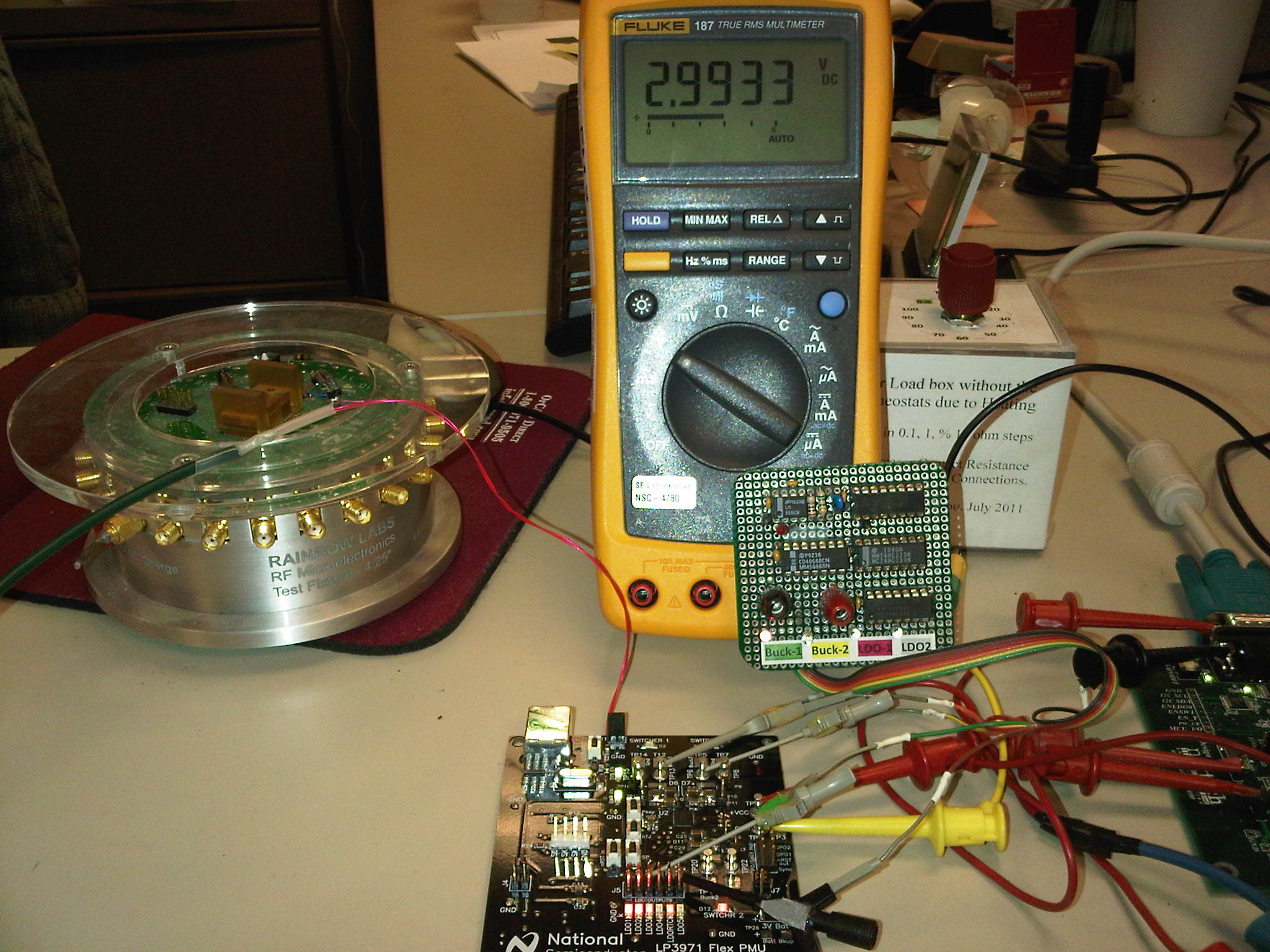

  • Hi Craig,
    I just got back to the office and wired up the newly arrived LP3971 EVB in my office. (See photos below.)   The default voltages of Buck1 and Buck2 in the PMU are 1.5 V and 1.8V  respectively, the buck1 on-indicator LED is too dim to show up, the DVM indicates the correct voltage.  The regulators whether loaded or not loaded the SYS-EN and PWR-EN tests appear normal, issued no sign of failure in enabling the regulators as reported.    I am perturbed by your phenomenon and especially on some delay was required.   Have you done similar "manual" testing as described below?   Would like to have glimpse of your set up ... a picture would be helpful.      It  bothers me when you conveyed that the phenomenon has been on going for many many moons!  And I like to apologize that you have not gotten the attention you deserve;  understandably this might have an element with the TI merger.
    Picture left atop shows the setup where EVB power by +5V switching supply.      Top right photo is an expanded view of the LP3971 EVB.  Note that the
    PWR_EN =SYS_EN tied togeter, either connected to +5V and cycling the               red wires by J1 jumper are the PWR_EN and SYS_EN wires used to control
    supply, or with the +5V supply on manually connect the enable-pins to GND         assertion of regulators.     Loading Buck1, Buck2 with a 1.5ohms power
    and +5V alternately.  Result:  the bucks always turn on properly.  A mux                  resistor does not show any adverse effects.  The system and powers controls
    contraption monitors 4 regulator outputs and feed them to a DVM.                            appear working normally.
    Please give me addition info and waveforms of the enable pins.  Also the circuit and time/amplitude information of the delay used will be nice. I will continue check it out in the lab to determine if amplitude, slew rate, etc. might be influencing the enabling functions.
