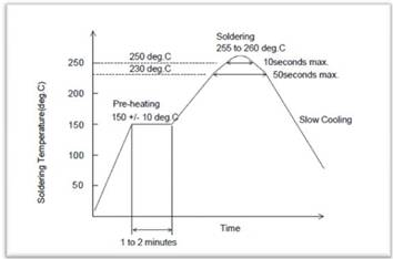

    6) The nano-module is soldered to the PCB by a reflow process. That means that the die on top of the module is "double-reflowed". Can't this second reflow weaken the connection of the die to the inductor? Are there any special reflow procedures for the module?
    The nano module can withstand 3 reflows at 250 deg C for 10 seconds, peaking at 260 deg C.
