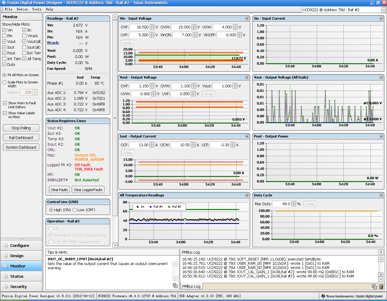

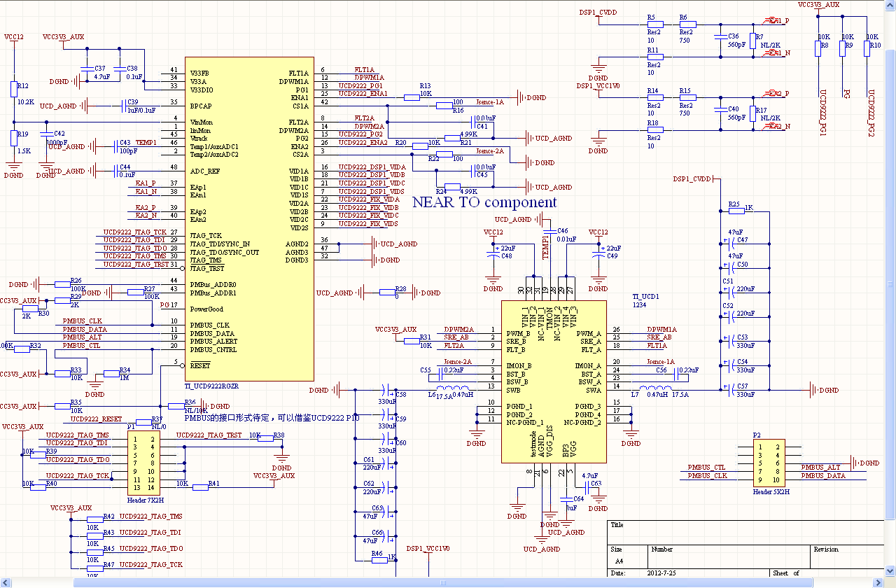

there is UCD9222+UCD7242 in my project about 6678.When I configure the UCD9222 through PMBus adapter,the UCD7242's output is zero.I find out that the DPWM1A and DPWM2A is 1.65V,so the UCD7242 shut the HS and LS.Does somebody know why the DPWMA is 1.65?
my configure file is the project file which is used in 6678evm,and I have pulled up ENA1 and ENA2,also the CTL.thanks.
