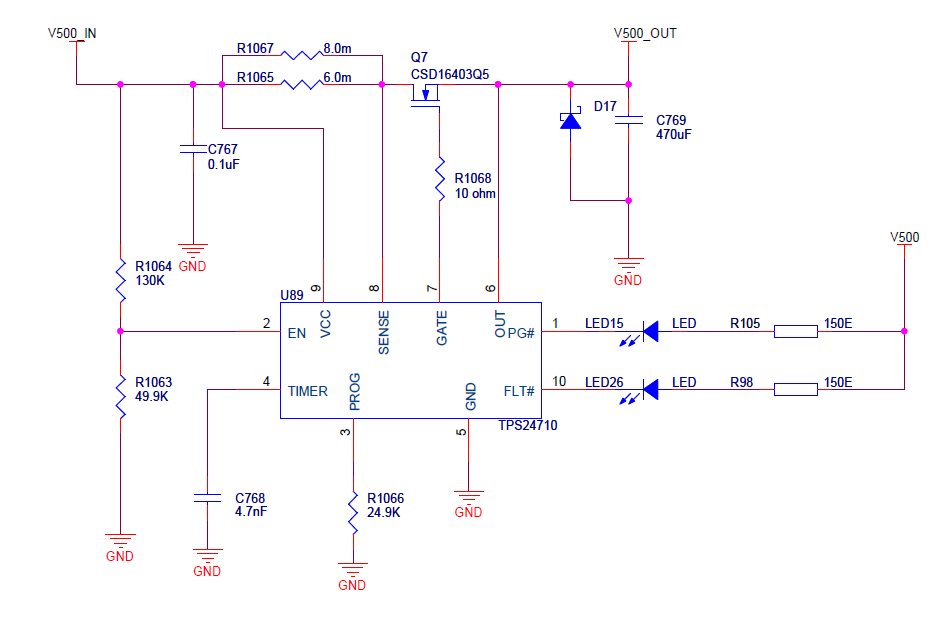

Hi all!!!
Below is shown a current limiting circuitry using TPS24710;
Requirements are:
Voltage: 4.9V to 6.0V
Current: 6 amps
Anyone can please review this design and confirm whether it will work for my requirements.
