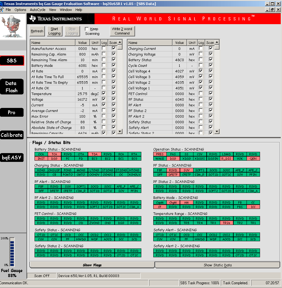

Hi!
I wrote about my problem in another thread: http://e2e.ti.com/support/power_management/battery_management/f/180/t/200595.aspx

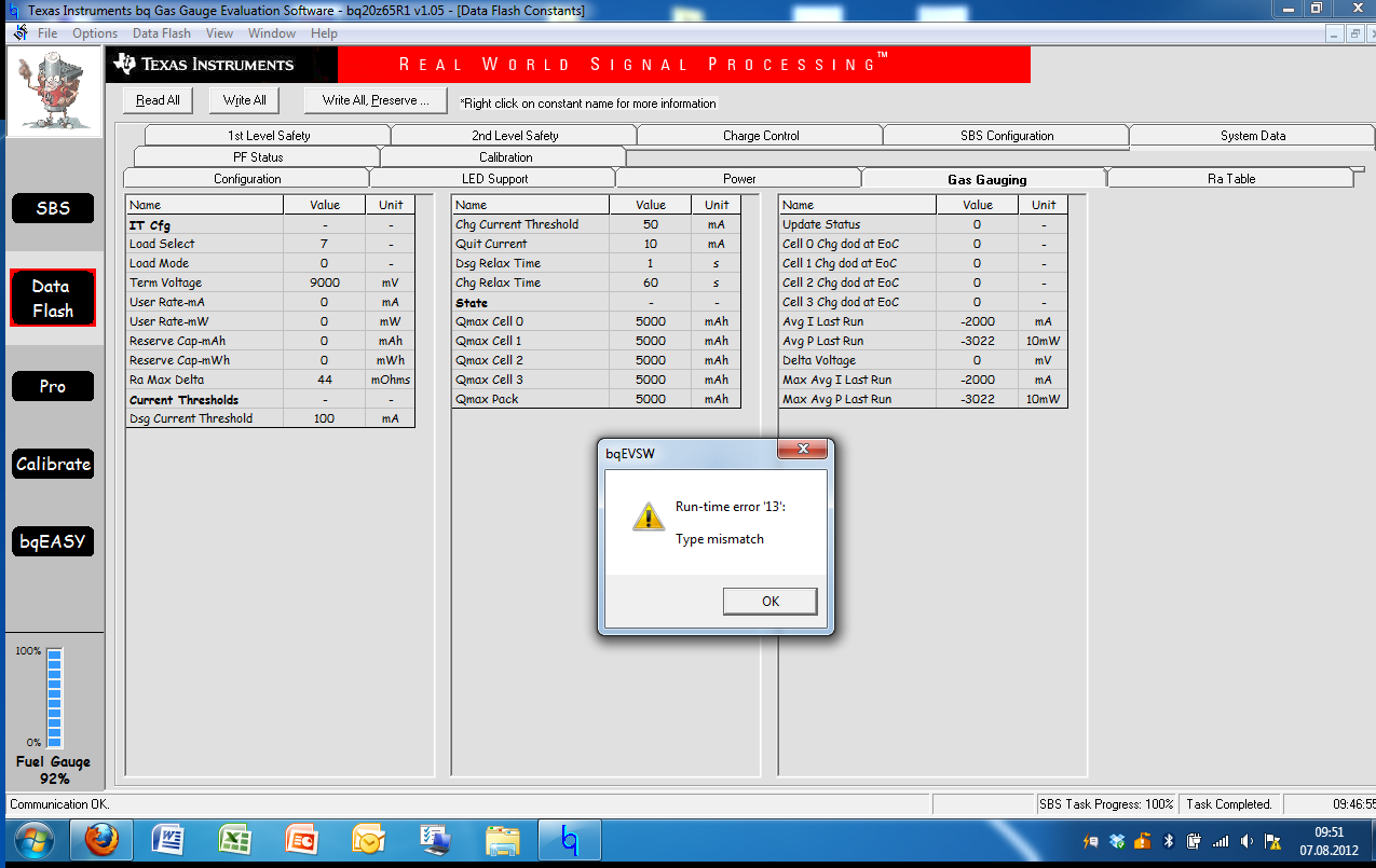

The device is unsealed, i don't have permanent failures and my battery voltage is above Flash Update OK Voltage....however, i'm able to do write and read operations to the data flash except the update status....it's strange and meanwhile frustrating....
I use another PC with WinXP, but there is the same problem "runtime error 13: type mismatch"....
Does it make sense to recalibrate the bq20z65-r1 altough Update Status has value 04?
