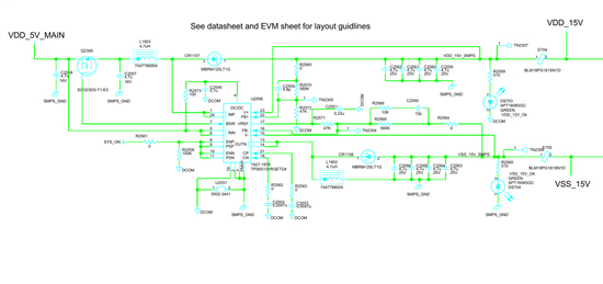

i'm using the TPS65131 for multiple of my designs adn now we are validating the first design and notce that the TPS65131 draws to much current even when no load is conneted. below is the schematic
i have removed teh firete beads to make sure that no load is connected. now when i apply 5V and enable the smps it starts drawing 350 - 425 mA???
I have checked that the diodes are mounted ok and they are. the +15V and -15V are generated.
when i remove the DIODE in the positive boost circuitry it also generates +15V but than without drawing the high current.
our board space is limited but we managed to stick to the ref design as much as possible but 100%.
What can cause the tps to draw such high current??
when i have the tps running and than i can connect the load and it keeps running but after power down and power up it will no start again whit load connected. i need to first disconnect??
pls advice
kind regards Martijn Broens

    yes i did mean CR1107. it so seams that the switcher than uses its internal fet forward diode for boosting, meaning it wil create the voltage but it will not be able to provide current.
    I already have an eval board and i already connected it to my own board but that the eval does nt draw this high inrush current. (@ the eval i hardwired PSP, PSN, ESP, ESN together and connected them to my sys_on (R2561))
    In the mean time we already verified 4 other boards and all with the same effect/result. unfortunatly i can not (for now) sen you a board as we can not miss it at the moment, we need them to verify the remainder of the board just by applying external +/-15V

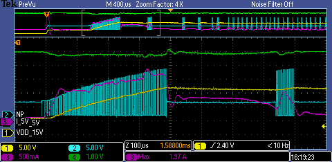

    please find below the snap shot from my scope
    What you see is the following:
    CH1 (Yellow): VDD_15V Output from switcher TN2307)
    CH2(Bleu): NP (measured between Boost inductor and Forward diode (L1903l CR1107)
    CH3 (Violet) I5v: current consumption of switcher.
    CH4 (Green) VDD_5Vin  5V supply
    The test setup is as follows:
    External powersupply set to 5V no current limit (max 10Amp).
    removed R2561 from design and added a switch between VDD_5V_MAIN and ENP node

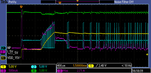

    powerup the board wait for the board to become running. this is why you already see current consumption of approx 250mA. than when i enable the switch the smps draws 2.69Amp inrush, way to high i would saythan after approx 121us the inrush peak is gone and current consuption falls to 230mA total.
    414us later the switcher kicks in and as such current again inreases to 1.73Amp and VDD_15V grows.

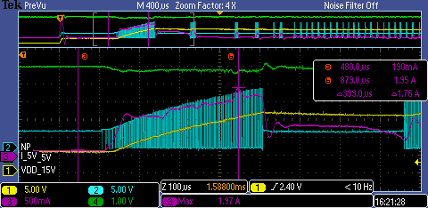

    than the first periode that the switcher does not seem to do anything current is falls from 1,73A to 710mA (Screenshot 3)
    than aftre the second periode current again drops to 210mA and Vout remains.
    be aware that all this is under NO_LOAD condition (E704 and E703 removed
    To me it still seems that the inrush is whats killing me as in our app we can not handle this large inrush. it will reset our SOC
    hope this helps
