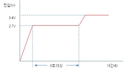

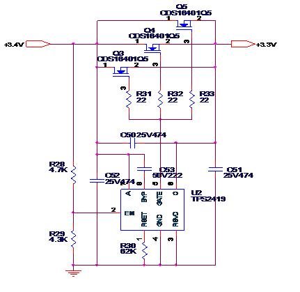

I have a problem with TPS2419.
When we are using 3 FETs with 1 TPS2419, The FETs are turned on delayed time is more than 3 second.
So, If you can advise for me to improve this phenomenon. Also how many FETs may I use at 1 TPS2419.
When I use only 2-FETs with 1 TPS2419, It is working well.
We are using recommended FET(CSD16401)
Please answer me.
And here is our circuit and turn on timing
