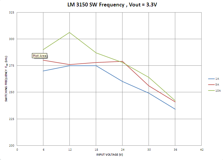

LM3150 provides constant on time regulation but I am wondering how much switching frequency changes depends on input voltage and output load condition.
For example could I get the data when input voltage changes 9V to 36V and output load changes 0A to 10A at 1.2Vo/5Vo?
The data from any similar condition should be OK, Thanks.
