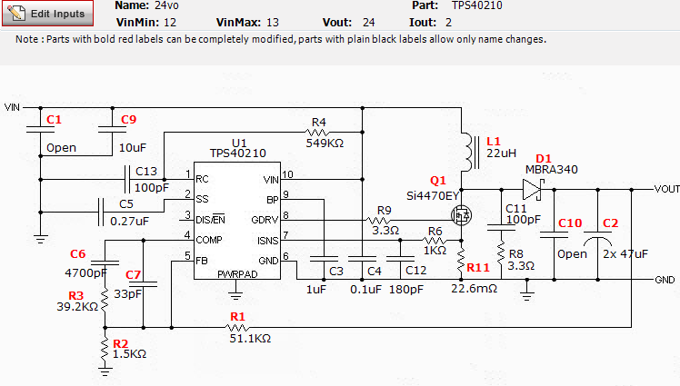

I implemented the design based on switch pro configuration as below :
But it didn't work.

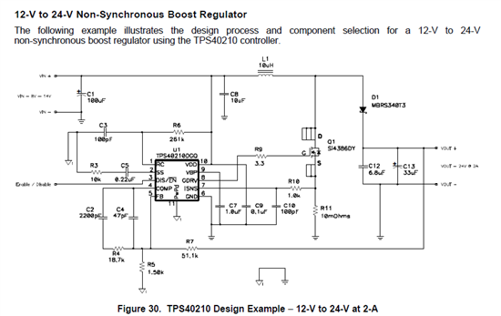

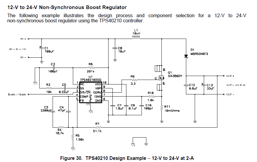

I have checked the datasheet, there is another configuration as below:
You can see there are some differences, Please let me know which configuration is correct.

    The main reason for the differences between the two designs is SwitcherPro defaults to a switching frequency of 300kHz while the design in the datasheet is designed at 600kHz. A switching frequency reduced by one half requires twice the inductance and output capacitance for the same ripple current and output voltage ripple respectively.
    Both configurations should work.

  • I used SI4386DY in Switch pro configuration, It is should be ok.
    Do you think is this the problem?
