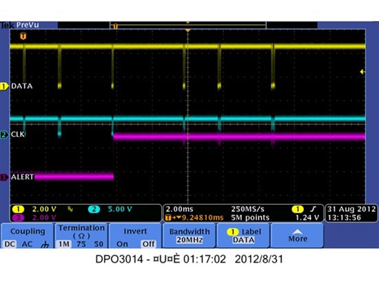

Dear Sir/Ms.
I log I2C command when Sending Clear Fault command.
The I2C command reading form Scope are as following
S<--Start , A<--ACK , P<--Stop, NA(Not ACK)
S 0x36 A(33W) 0x00 A 0xFF A 0x6F A P
S 0x36 A(33W) 0x00 A 0x37 A 0x81 A 0xB1 NA P
S 0x36 A(33W) 0x03 A 0x8EA P
Alert High
S 0x36 A 0x00 A 0xFF A 0x6F A P
S 0x36A 0x00 A S 0x37A 0x81A 0xC1 NA P
S 0x36 A 0x03 A 0x8E A P
Alert High
S 0x36 A 0x00 A 0x01 A 0x9B A P
S 0x36 A 0x01 A 0x48 NA P
S 0x36 A 0x79 A S 0x37 A 0x00 A 0x00 A 0x7E NA P
I can not match to PMBUS Log.

I Try Twice time and the result is is same. Is there something wrong?
